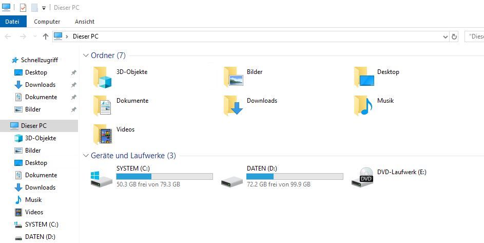

I think there is enough space  and I have already made the upgrade plan...

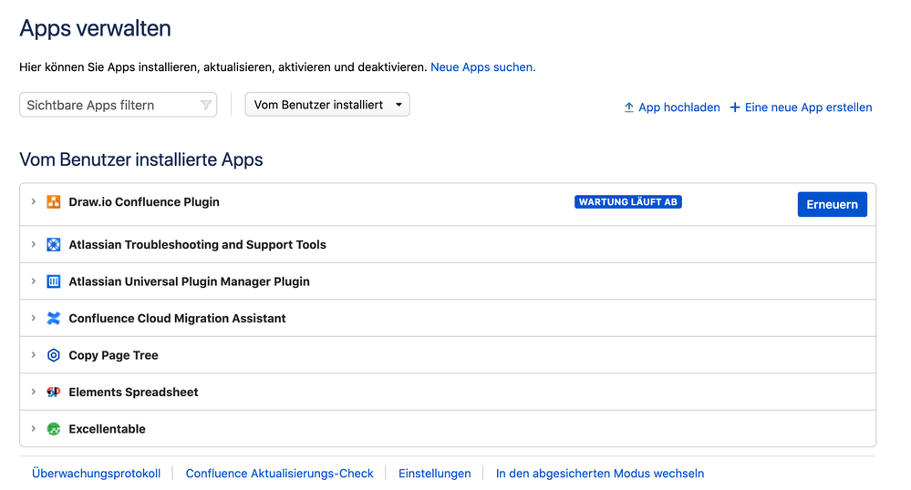

And here are our Addins/Apps... just a few... And we use these for years now...

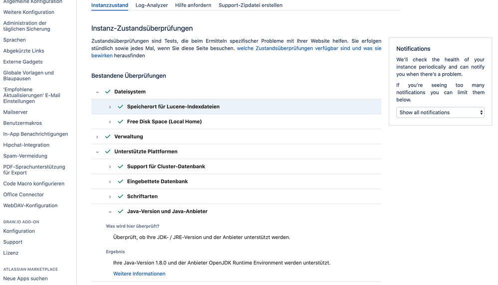

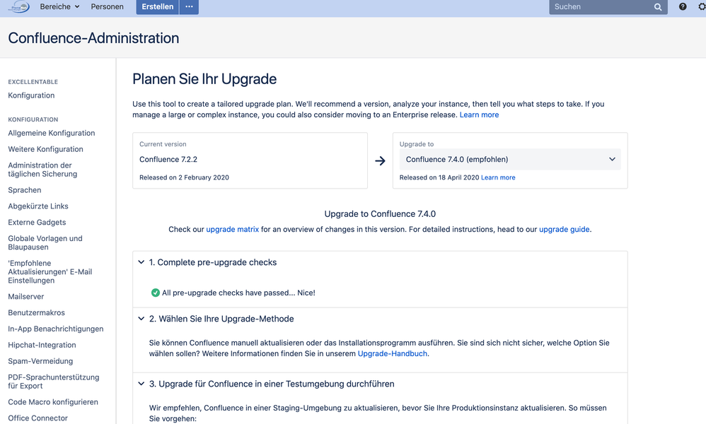

April 23, 2020
We use the Java 1.8 - it was installed with the Confluence Windows Installer...
There was never another Java instance or something similiar on this server...
Do you think we have to upgrade to Java 11 before we upgraded to Confluence 7.4?
And how can we do this?
