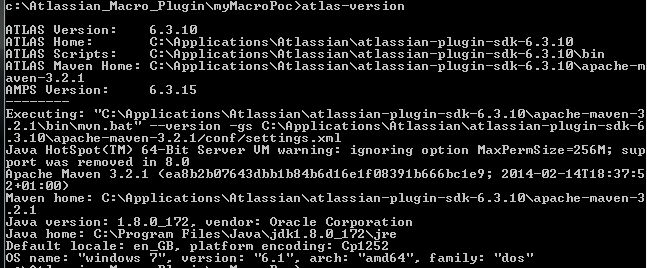

I'm under Windows.
atlassian confluence version:
I installed and run once the confluence atlassian and everything was fine.

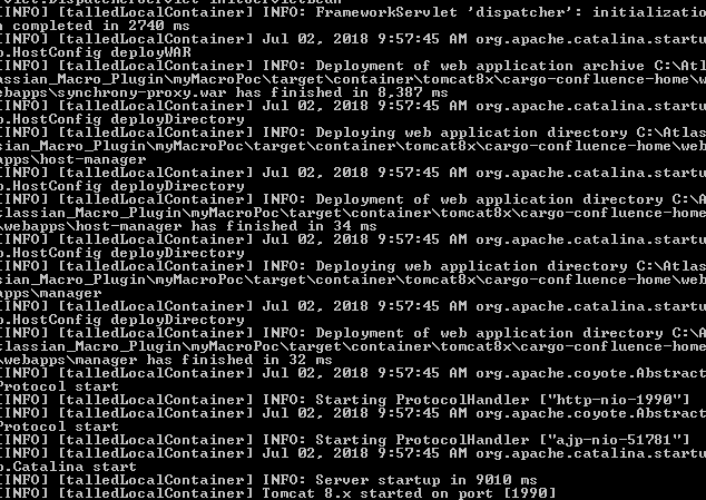

I have been through the tutorial creating confluence macro. Imported the project into Eclipse.. created the Java class required and And after build, install and run the plugin via
atlas-mvn eclipse:eclipse
then
atlas-run
it seems that confluence restart and should be available on 1990 port in my case http://NOM_MACHINE:1990/confluence and not http://localhost:1990/confluence

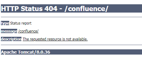

when I request it I got the error:
Anyone can help on this?

Okay I figured out the problem.. I was not working under the active eclipse workspace.. after retrying with the right workspace it worked fine.

You need to have a read of the Confluence application log - it looks like the Tomcat is starting up fine, but the plugin you have compiled is preventing Confluence from starting within that.  There should be details within the application log about that.

in addition in the logs:
127.0.0.1 - - [02/Jul/2018:09:57:47 +0200] "GET /cargocpc/index.html HTTP/1.1" 200 124
0:0:0:0:0:0:0:1 - - [02/Jul/2018:09:58:38 +0200] "GET /confluence HTTP/1.1" 302 -
0:0:0:0:0:0:0:1 - - [02/Jul/2018:09:58:38 +0200] "GET /confluence/ HTTP/1.1" 404 1016
0:0:0:0:0:0:0:1 - - [02/Jul/2018:09:58:38 +0200] "GET /favicon.ico HTTP/1.1" 404 -
10.15.12.32 - - [02/Jul/2018:09:59:17 +0200] "GET /confluence HTTP/1.1" 302 -
10.15.12.32 - - [02/Jul/2018:09:59:17 +0200] "GET /confluence/ HTTP/1.1" 404 1016
10.15.12.32 - - [02/Jul/2018:09:59:18 +0200] "GET /favicon.ico HTTP/1.1" 404 -
