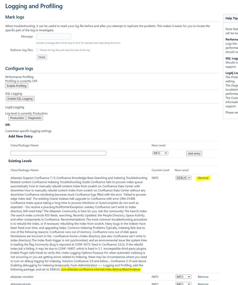

When I copied the first line of the Class/Packages;
com.atlassian.confluence.internal.index.AbstractBatchIndexer
I accidently copied all the text from the webpage above that time, pasted it into the text field, and saved ... ending up with this;
When I attempt to remove this, I get a;
Server Error
404 - File or directory not found.
The resource you are looking for might have been removed, had its name changed, or is temporarily unavailable.
Any ideas on how I can fix this ?
I've tried finding where the deleteLogEntry.action is from IIS logs where is points to the configurelog4j.vm but I have no idea how to remove this entry.

Hi @Intelligence Systems Welcome to the community!
For now you can re-add the correct entry and ignore the incorrect one as long as its not affecting your instance. I couldn't find enough documentation around this and removing it might be done via database queries, so raising a ticket with Atlassian support would be the best bet.

Thanks Kishan, I did raise a ticket with Support and got the issue resolved.
Would you believe that a simple server reboot cleared the issue.
The Class/Package when added is just held in RAM and a server reboot clears this back to standard.
Adding in a Class/Package persistently, will not be cleared after a reboot, lucky I didn't do that.
