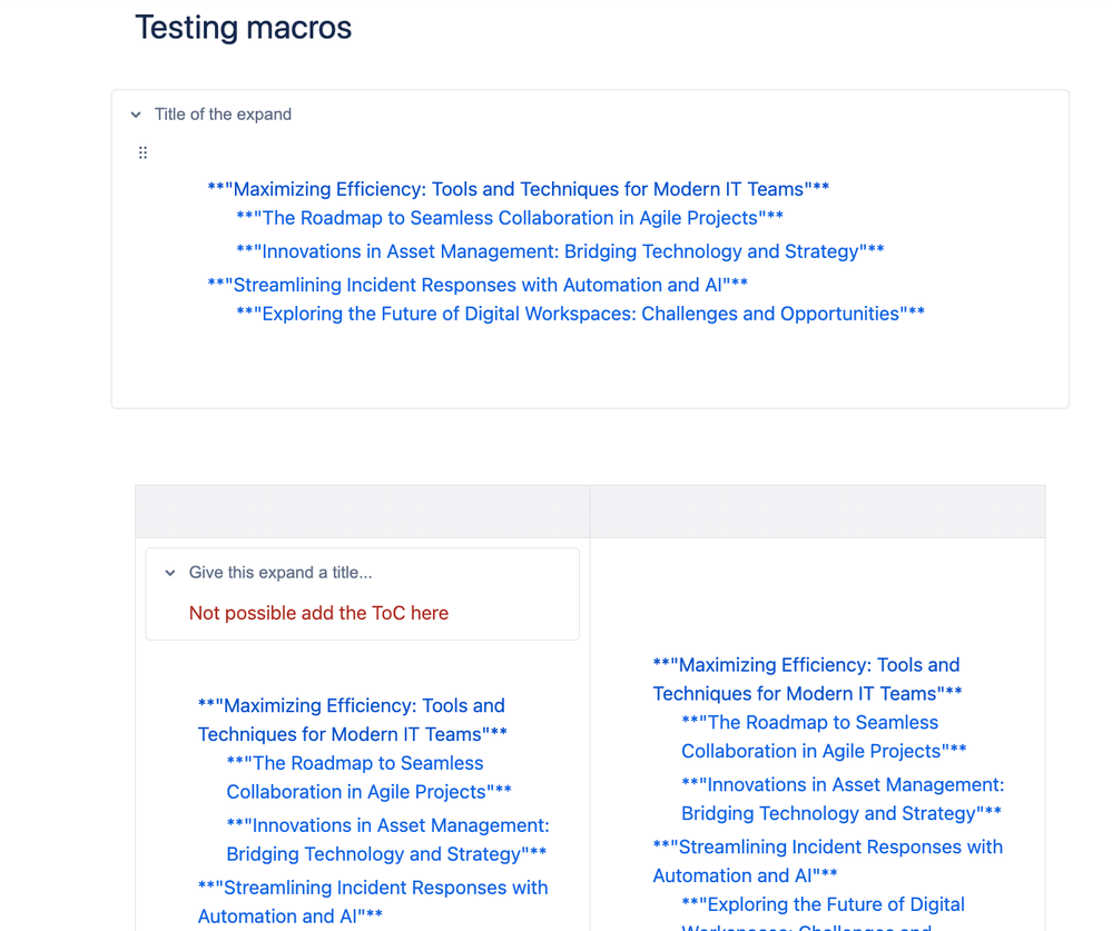

As @Kristian Klima shared, it's possible to use the expand macro within the table cell. However, you can not add a ToC macro inside this expand.
You are able to add a ToC within a expand macro only when the expand macro is on the page:

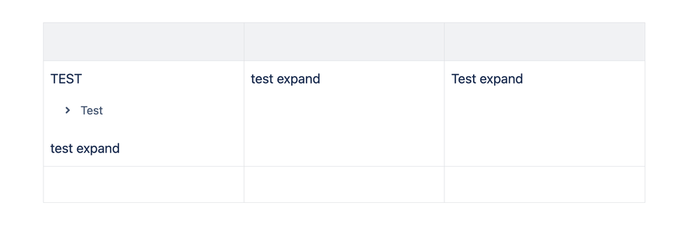

...and it works as expected (the macro expands).

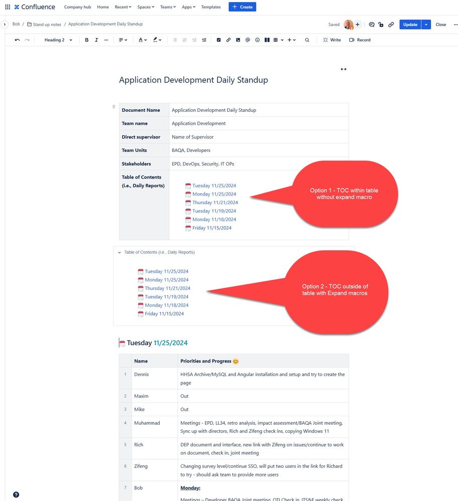

Thanks for the follow up. I inserted a screen shot for your reference. Option 1 has the TOC in the table without using expand which will result in long list of links. Option 2 is the TOC macro inside the expand macro but outside the table. This is not a bad option. I was trying to see if the TOC macro could be inside the expand macro in the table. Mariana confirm this is not possible, which is what I was experiencing. I wanted to make sure I wasn't just making a mistake.
