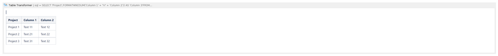

Wrap your Jira Issues macro in the Table Transformer macro:
On the screenshot I use a manually created table, but this is only for a more clear example - the Jira Issues macro' output is fully supported by the app.

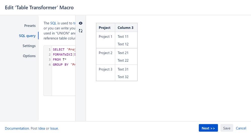

Then use a simple SQL query where you list what columns you need to show as they are ("Project" for my example) and merge the required columns ("Column 1" and "Column 2" for the case):
SELECT 'Project',
FORMATWIKI(SUM('Column 1' + "\n" + 'Column 2')) AS 'Column 3'
FROM T*
GROUP BY 'Project'
And here is the result:
Hope this helps your case.

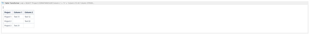

One more question though... Going back to Katerina's example, if Column 1 and Column 2 have data in them, it merges beautifully (using the SQL that was provided).
However, if Column 1 or Column 2 is blank, then the merge is completely blank as well. How do I at least show the partial data? For example, what if Column 1 has info, but Column 2 doesn't? I still want the new, Column 3 to show the info from Column 1?

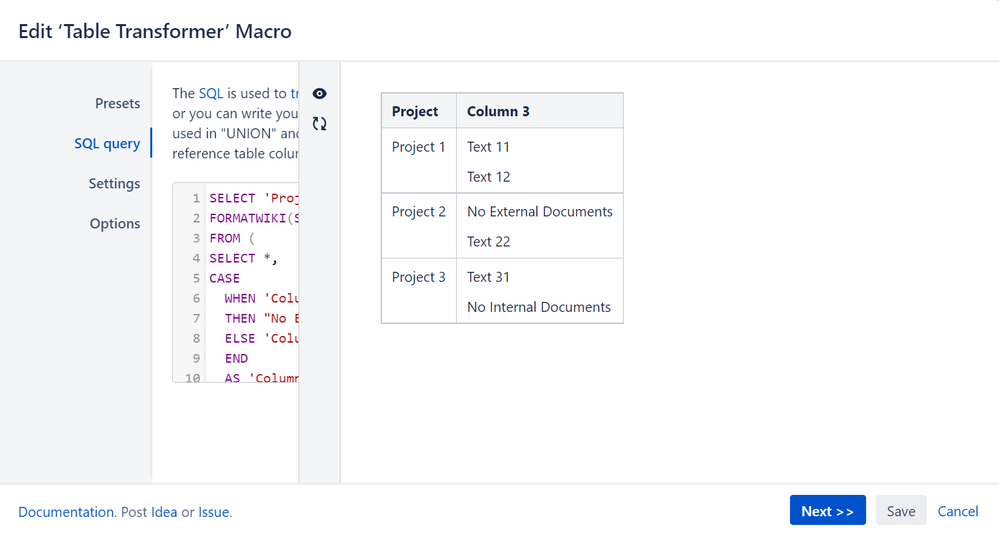

Try to modify your SQL query in the following way:
SELECT 'Project',
FROM (
SELECT *,
CASE
WHEN 'Column 1' IS NULL
THEN "No External Documents"
ELSE 'Column 1'
END
AS 'Column 1',
CASE
WHEN 'Column 2' IS NULL
THEN "No Internal Documents"
ELSE 'Column 2'
END
AS 'Column 2'
FROM T*)
GROUP BY 'Project'
Here we fill the blank cells and then merge the two columns. Hope it works for you.
