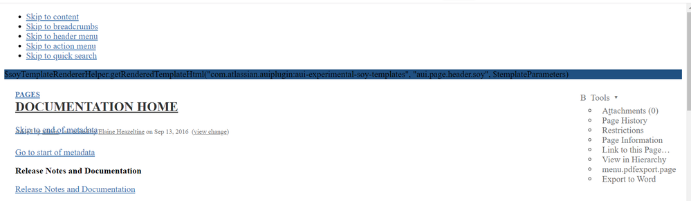

Hi @Nic Brough -Adaptavist-  we are getting the following error when we upgraded from 4.3.7 to 5.0.3 it looks like some plugins issue can you pls guide me .I have attached the screen shot for the same .
Also @Nic Brough -Adaptavist- in 3.5/4.2.7/4.3.7/5.0.3 we are not able to find manage add-ons/manage plugins  in admin page .Confluence_Error.PNG
