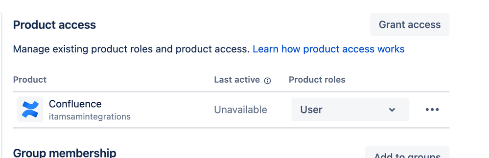

Hi @marc -Collabello--Phase Locked-
When you say normal user, do you mean user with the below role in Admin portal :
June 5, 2024
yes.  It's simplest to just test the API route in your browser when you are logged into Confluence, as the authentication cookies are already set up.
