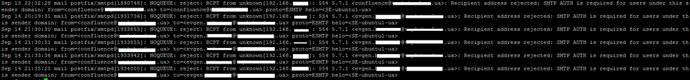

Dialectik
September 16, 2021
Firewall is not a problem because there is no firewall except fail2ban - but this ip is whitelisted. log from server:
