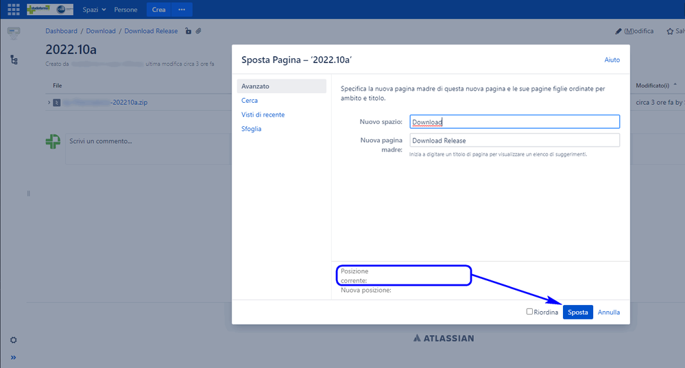

Confluence Server upgraded from 7.14.1 to 7.18.2 few days ago.
Now it is not possibile to move nor reorder a Confluence page if it contains the Attachment macro.
Click the blue "Move" button and nothing happens.
Same behaviour with a new page or existing one, with or without attachment.
Same behaviour using "Advanced", "Search", "Recently visited" or "Browse" options in the left bar.
Additional info: the "Current position" area is not filled.
Is this a bug or a wrong configuration?
For now the only workaround is to create a new void page under the right "father", reorder it in the correct place in the child list and then add the Attachment macro. But we can't keep this workflow for long so we need a solution.
Thank you

Hi @Ste DB ,
from the provided screenshoot, it seems that your page is already in that location. In order to move it you need a new space or a new location within your Download space (through "Nuova pagina madre"). After doing that, Move/Sposta button should correctly work moving your page.
Could you try?
Fabio
Ste DB
October 4, 2022
I Fabio thank you for the answer
Sorry, I didn't switch on the "Reorder" check while taking that screenshot.
It was meant to show the problem in the "reorder children list" scenario.

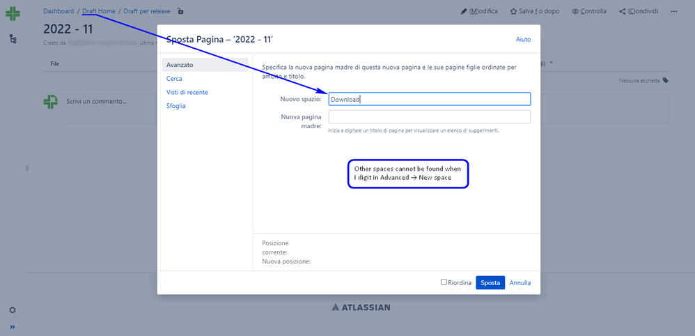

This is because the problem appears both when I change location space and when I reorder the page between children of the same location.
Main problem seems to start when I try to change space: other spaces are never suggested when digit.
This happens both in Advanced (Avanzato) and Search (Cerca) functions in the left bar.
I already tried the administration function to rebuild the contents index but nothing changed.

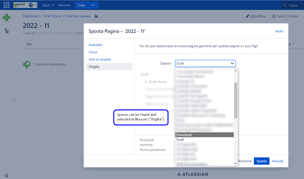

Anyway, spaces can be found and selected with Browse (Sfoglia) but in the end nothing changes for the Move.

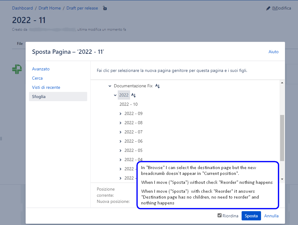

In Browse, destination page can be selected but Current position breadcrumb (Posizione corrente) is not filled.
If I click Move ("Sposta") without check "Reorder" (Riordina) nothing happens.
If I click Move ("Sposta") with check "Reorder" (Riordina) the Reorder function is shown but it always answers "Destination page has no children, no need to reorder" even where there are plenty of children pages.
