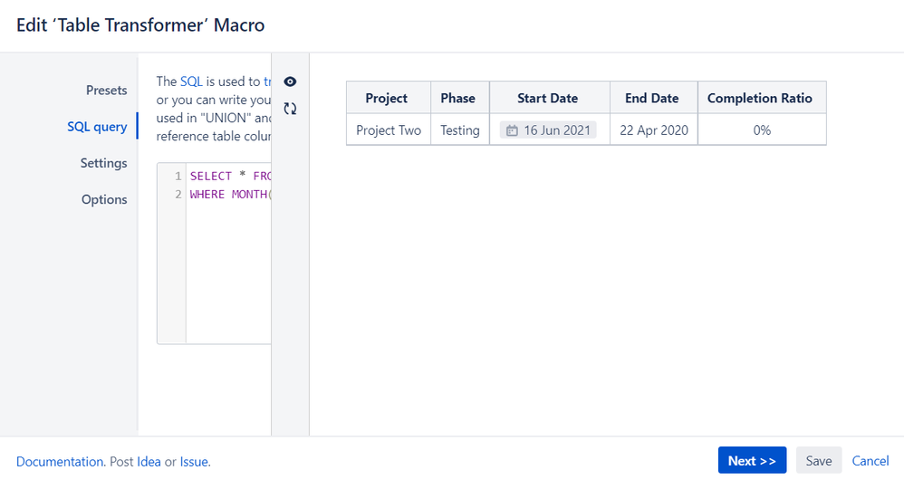

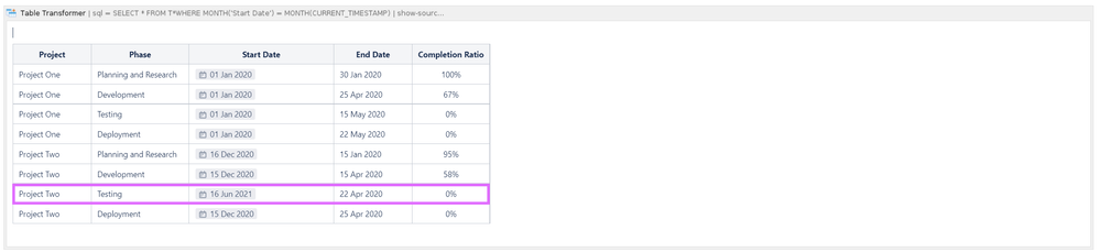

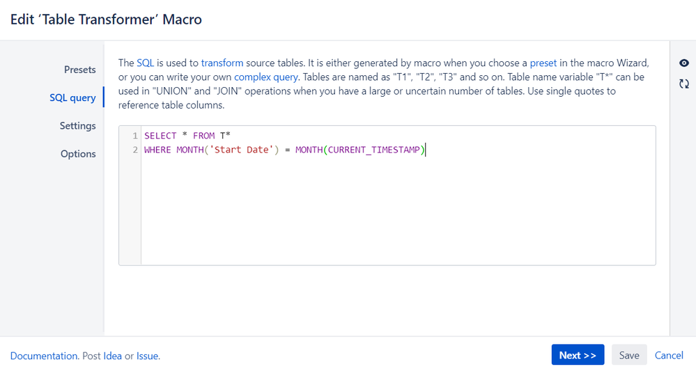

Hi @Timur ,
I couldn't replicate the issue on our test Server instance:

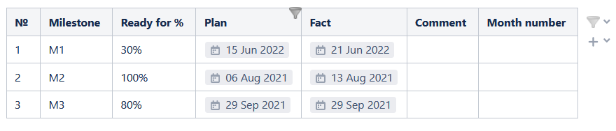

Timur
June 20, 2022
xmm, interesting. For me it create new column, but every cell is empty
let me try with new table
Timur
June 21, 2022
Katerina Kovriga _Stiltsoft_
June 21, 2022
It means that the function is not working (and so is the initial query - it doesn't get the number for your WHERE condition) - update the app and check the results.
