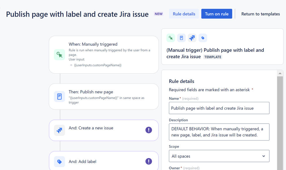

Have you tried using this automation, I think it does what you are describing:

Thanks @Ben Finn . I've found indeed an automation like that, but how can I copy fields from Confluence (e.g. description) to the summary of the jira item?

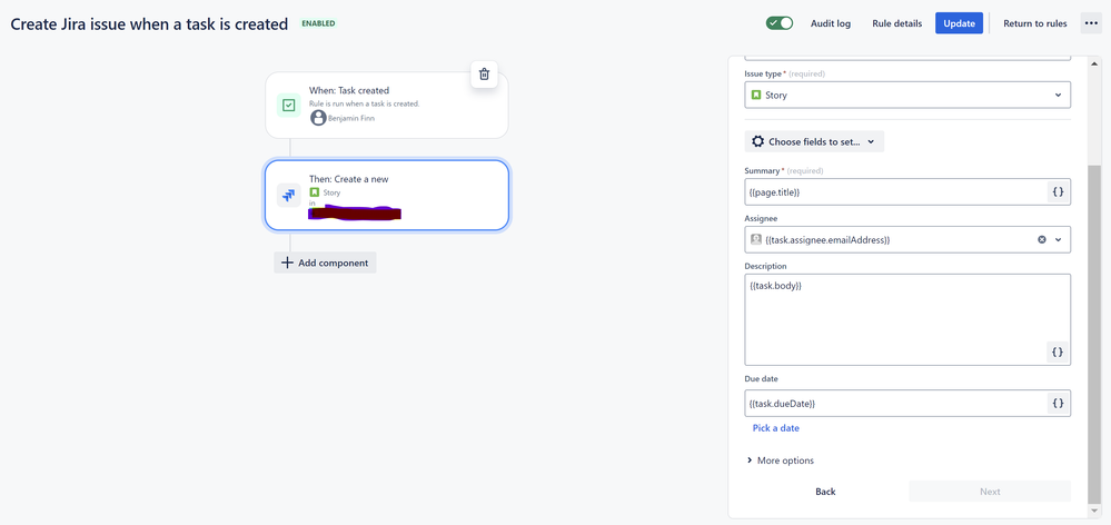

I did some testing for you and here is an idea but it would require a bit of a change. Rather than setting it to create when a new page is created, you can set it to create when a task (action item) is created.
I created a page and used the "/action item" to have the trigger go off. The @Name is the assignee, body is just text and the date is the /date function.

You can find the list of Confluence Smart Values here: https://support.atlassian.com/cloud-automation/docs/smart-values-in-confluence-automation/#Task-properties
Below is the automation.
The problem with having them make a page is getting the smart values to identify each piece. You may be able to look through that list above and find better smart values but will this work for you?

Hi @Ben Finn , thanks. This works. I can create a page with a task and then a jira is being created. Thanks for that.

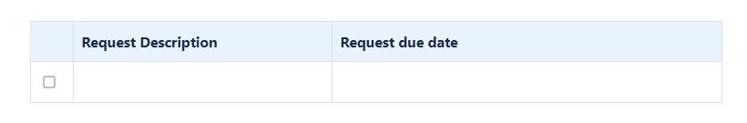

It only works when I create the task and immediately put the information behind the task (task body). Is it also possible that I make some kind of table for a task? Something like below. It doesn't need to have the same structure. Jiratask.jpg
We need to make it as easy as possible for the requesters to create a new item.

I tested it out, as I'm sure you did, and it does not work in that format. Took a look again at the smart values but there is no smart value related to a table which is understandable as it would be hard to identify which table in the page is the table you want to use tasks are easy because it gives the system some direction.
There are smart values related to the content of the page and it will can make the page creator assignee. this would, of course, limit the ability to control the assignee, which may be acceptable to you.
However you have one big issue, if you look at the smart values you will also find there are no smart values related to date except for due date in task or system-controlled updated/created dates.
I'm afraid using this methodology, this is as far as you can go, to go any further you will have to take the advice of Joey and create a custom solution which you may be able to parse information from such as date.

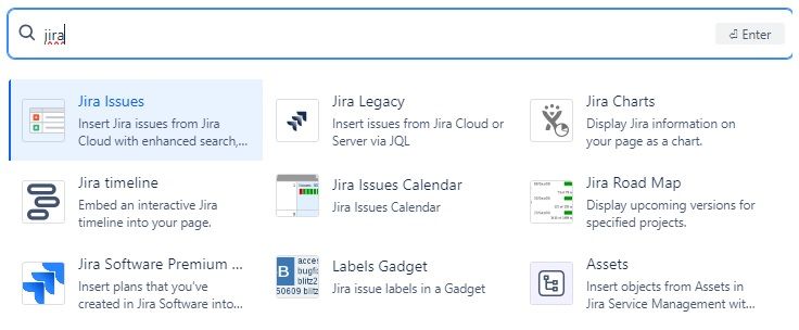

  1. Use the Jira Confluence integration to create a Jira issue directly from Confluence. You can configure a Confluence page template with the Jira macro, which helps in creating Jira issues with specific fields.

1. I don't think we have this macro you mention. Only to insert Jira's into Confluence.Confluencejira.jpg
