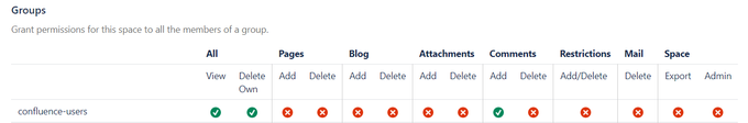

It look like I can create a calendar and attach it to ANY space.
Here I'm logged in as a local user that has the following permission in the 'IT Hub' space:
I can still create and add a calendar to the space.
Thoughts?

Jonathan Smith
July 23, 2018
Are you a Confluence administrator with that user account? If so, try with a non-admin.
