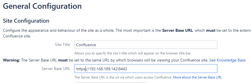

I'm now at "configuring the Server Base URL"
Mine is currently:
So I change to:
Run
$ sudo /etc/init.d/confluence restart
And the https page doesn't load.
The port number changes too, so the new URL will be:
And if you forward that port (and Synchrony port 8091) to your server, then you can access your server when not at home.
This is what I change it too and hit save and try and get to https://192.168.189.142:8443 and the page fails to load. I can't telnet to 8443 either, just 8090.
