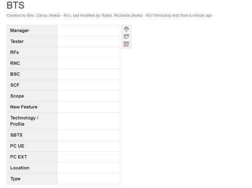

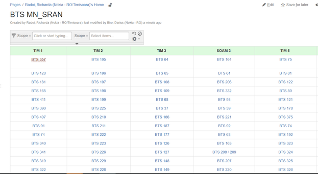

Here is the parent table with links to the child pages:
And here is a child page:
My question is if i can add filters on the parent table to get data from the child page? Ex: add a filter for location on the parent table and all the child pages with that specific location will appear

I suppose Page Properties Report should do the trick:
  • Wrap all child pages' tables with Page Properties macros.
  • Add PPR macro to the parent page.
  • Filter PPR report with Table Filter macro.
