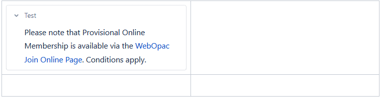

I was able to add an expander macro into a cell within a table in Confluence Cloud and it didn't move etc.

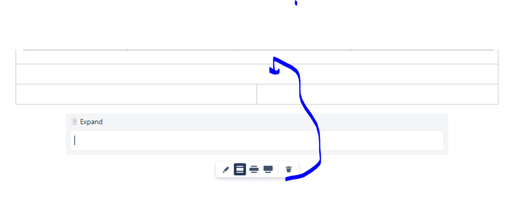

macroissue.PNGThe latest version of Confluence with different tables does not support adding the macro to a row. It drops it to the bottom, outside, of the table.

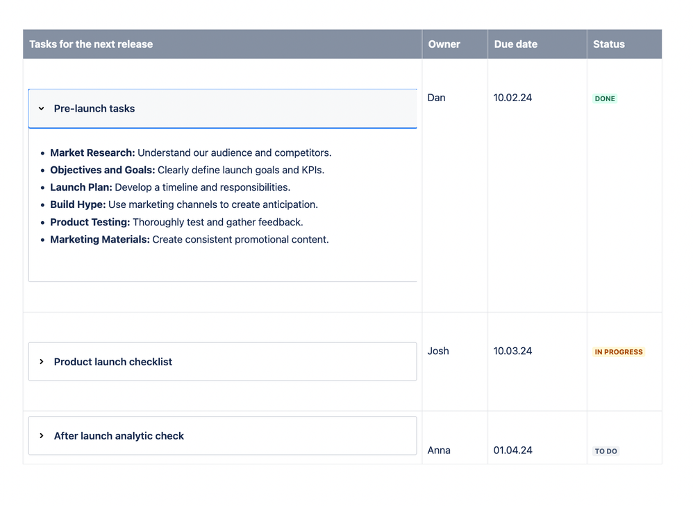

Now there is a solution for expanding inside table cells, but not as a built-in feature but as a third-party app from the Atlassian marketplace - Content Formatting Macros for Confluence. It has an advanced expand macro that can be added inside table cells and tabs.
Screenshot 2024-09-18 at 09.14.32.pngIt was developed by my team, so let me know if you have any questions.
