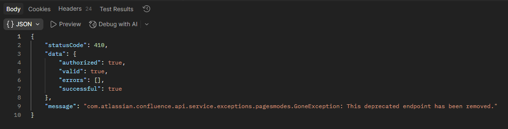

Tomislav Tobijas
June 11, 2026
@Darren Johnston I've tried
https://<sitename>.atlassian.net/wiki/rest/api/group/userByGroupId
and I got this as a response.
Then I looked at the official REST API docs, but it would appear that some v1 endpoints do not have a counterpart in v2 > see CONFCLOUD-82717: Missing REST API endpoints in Confluence API V2
You could probably work around with available endpoints, but it might be tricker than it used to be with the endpoint you've shared 👀
