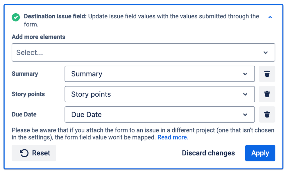

Jira doesn’t natively support advanced form calculations, but you can achieve basic tracking using custom fields and Jira automation. Here’s how to handle vacation requests using both native Jira and Smart Jira Forms, focusing on how to best use forms within issues versus shared forms.
Date Fields and Basic Calculation:
{{issue.End Date.diff(issue.Start Date).days}}.Tracking Leave Balance:
Smart Jira Forms offers two main approaches: forms added directly to Jira issues and shared forms using the “Create Issue” feature. Each approach has unique benefits and ways to track vacation balances.

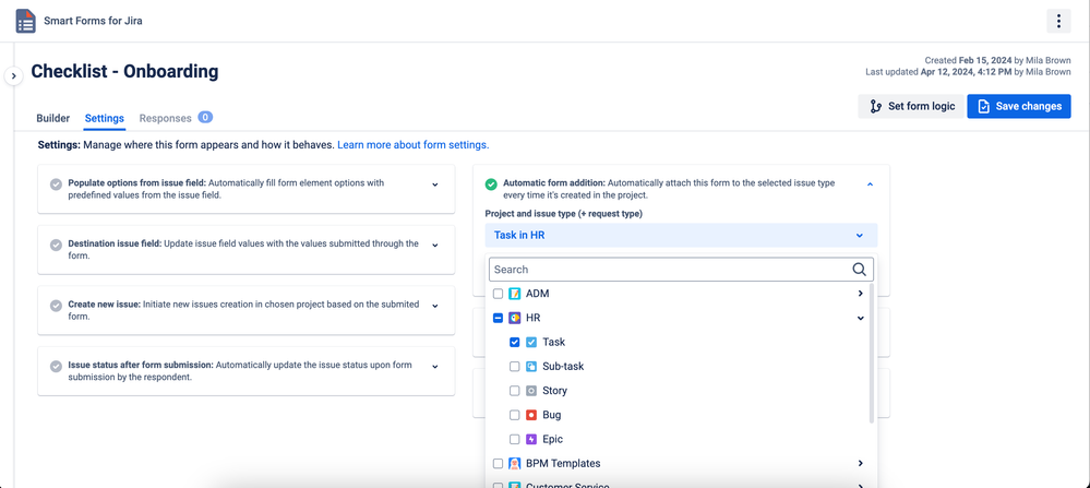

Setting Up the Form:
Auto-Attach Forms to Issues:
Using Update existing issue fields:
Tracking and Updating Vacation Days:
Form Setup and Sharing:

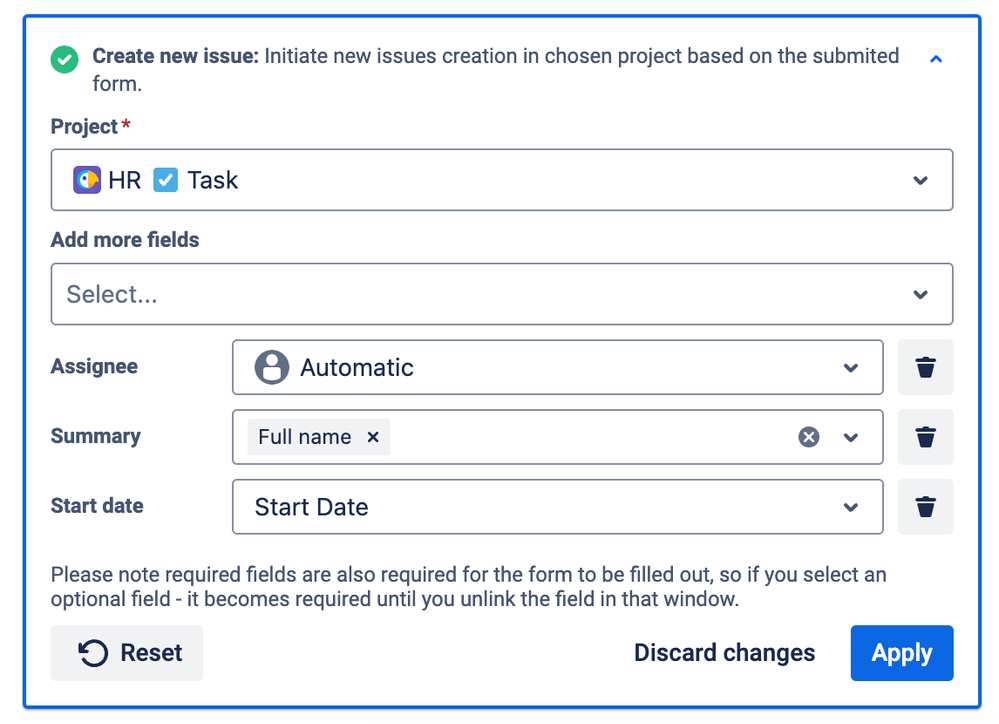

Using the Create issue from form submission Feature:
Central Tracking Issue for Vacation Balances:
Automation to Update the Central Tracker:
Link Requests to the Tracker(optional):

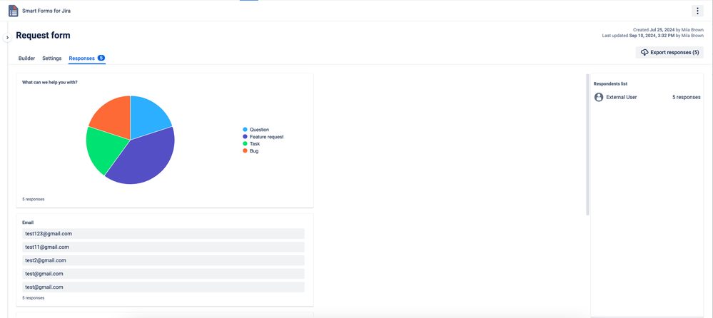

Analyzing Responses to Monitor Total Vacation Days Taken:

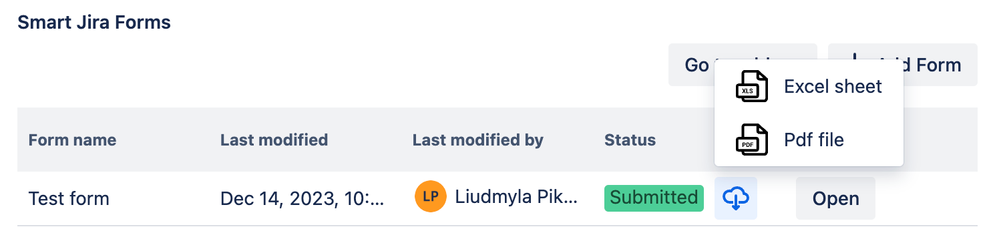

Export to external tools as Exel or PDF
