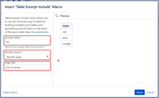

1. Create a page and add the table with the master list. Wrap the table with the Table Excerpt macro.
2. Excerpt the master list with the help of the Table Excerpt Include macro on any page.

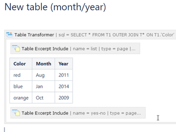

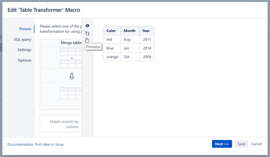

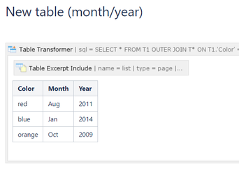

3. Add the table with the custom columns, place the Table Excerpt Include macro and the table with the custom columns in the Table Transformer macro body.

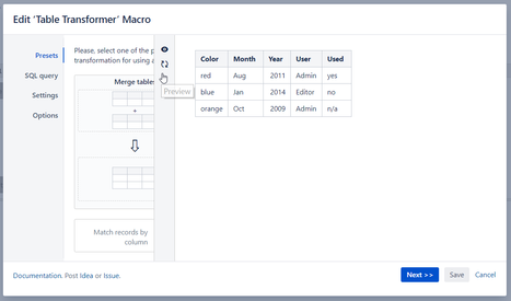

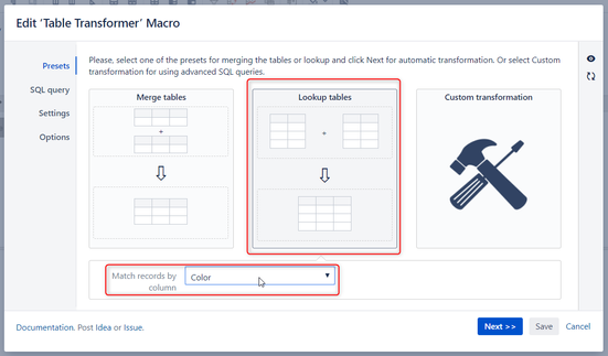

5. Use the Lookup tables preset to merge tables by the Color column.
6. If you need to add the data from the separated page, use the Table Excerpt and Table Excerpt Include macros as well and merge these tables using the Table Transformer macro.
