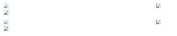

2. That looks like we're not able to get the expected response, so it's rendering as a broken image. It's quite likely related to the Jenkins plugin as our code should wait to timeout (which is a different problem in and of itself). I think I'm going to struggle to test this as I don't have a Jenkins instance to hand. If you have someone who has access to those Jenkins elements that can run the export of the page as a PDF to test, that would help isolate it. If the plugin is contributing to the issue, then having someone with the appropriate permissions run the script should allow it to export promptly and accurately on those pages.

2. I don't know if it helps but (except some normal text) this is what I see on such page:
If I right click on the icon and copy address it gets me to Jenkins. When I give it my credentials it says that I'm "missing the Overall/Read permission", so as you've wrote this might be related to third party (Jenkins) plugin. Although I think that from user perspective export mechanism should still somehow timeout or return error.

  2. Confluence doesn't support limiting specific components behind permissions, so this sounds like the functionality may be provided by a third party plugin. Our exports will continue running until they complete, though there are internal timeouts on elements inside the PDF conversion process. Without knowing what's affecting this export, I can't comment on why it's not completing. I've never before seen this process hang, so it might be related to third part code.
