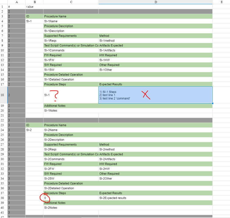

the pics have my setup
(pic 1)
1.1 my main table with all the columns where each row would be a procedure
1.2 the steps cell would need to be multiple lines which is already a pain to do in cells.

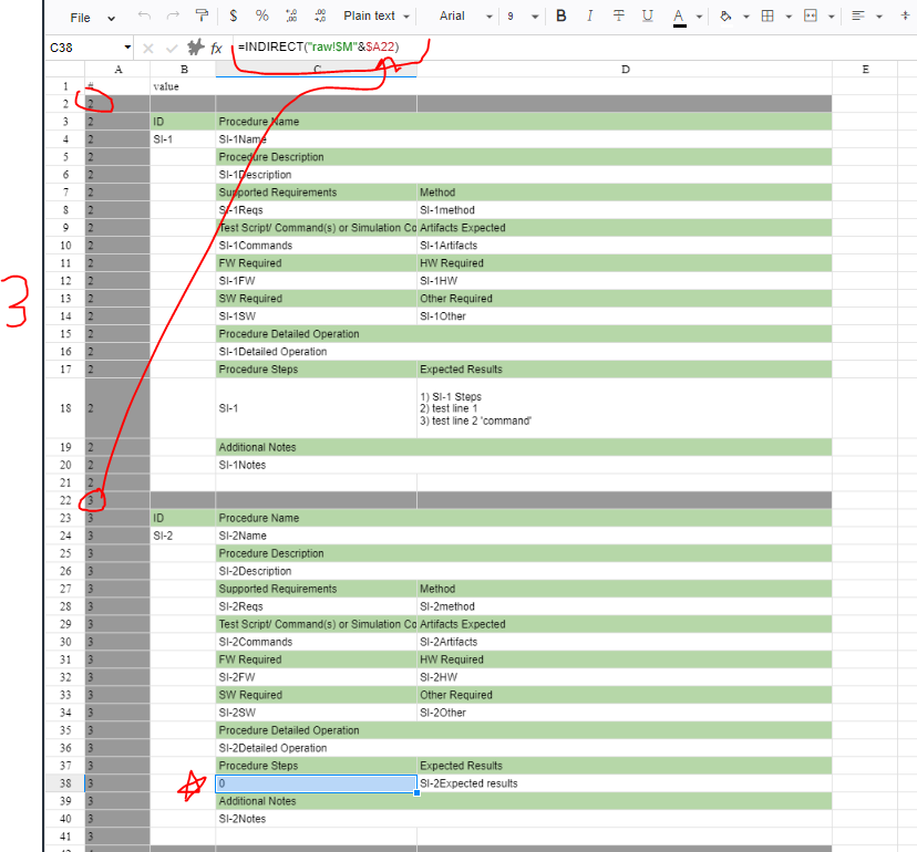

(pic2)
2.1 my formatted Table using the indirect reference combined with a row # on the left most section. I use the Heading (#, value) to do filtering on the confluence page.
2.2 I run into issues with copying the whole formatted section which is annoying but no the end of the world since I cant mostly (sometimes not?) copy the green row sections down.
2.3 I have weird issues though with the INDIRECT function (or other sheet refrences) where it does not update with the source cell. there are 2 results that I will get with that function.
2.3.1 it outputs old cell information (? below)
2.3.2 it outputs 0 when there are multiple lines in a cell
2.3.3 the X indicates me directly referencing the correct cell (=raw!M2)

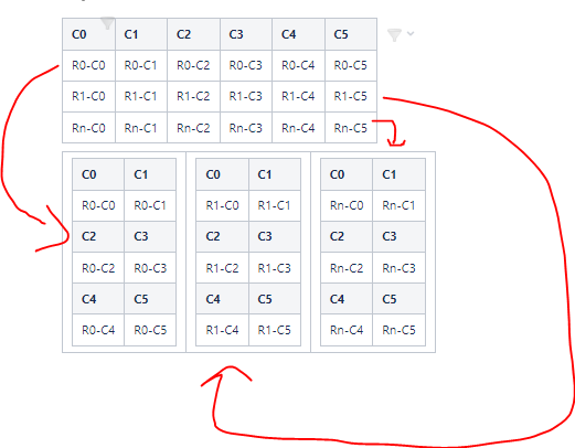

(pic3)
3.1 Im using the INDIRECT function which works for all cells except the multiline ones.
3.2 I am using this function because me copying and pasting this over and over and updating 1 character is not a good use of time or long term usable. and since I cant drag the whole block down and just get it to auto-update

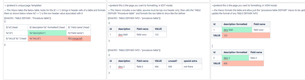

Truthfully what I would like is a Macro combination that has a single layout macro that defines the location and layout of content, then an input macro that takes a table and parses out the columns into the layout.
something like the attached which i dont think exists (at least is not available to me)
