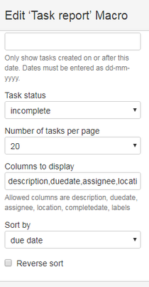

hi Bruce,
Did you follow exact below steps to add a task?
  1. type [] (this will give you a check box like shown in below image)1.1.png
  2. Type you task in the area that says 'Type your task here, using...
  3. and in your task report macro verify macro settings. Also you have to save the blog post so that the newly created task will appear in you task report 1.2.png
