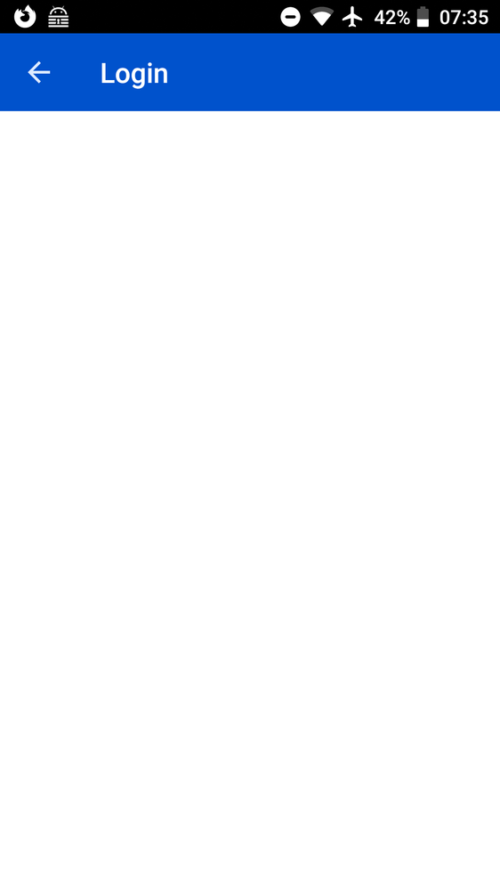

When I try to set up the mobile app(version 0.4.3) on different Android phones it is not possible to log in to the confluence server(version 7.3.5). The App can connect to the server but the login page is empty except the title. With the webbrowser the login is working without problem.

The Server Base URL was not the same like the address which I used for the mobile app. After correcting that it worked as expected.
