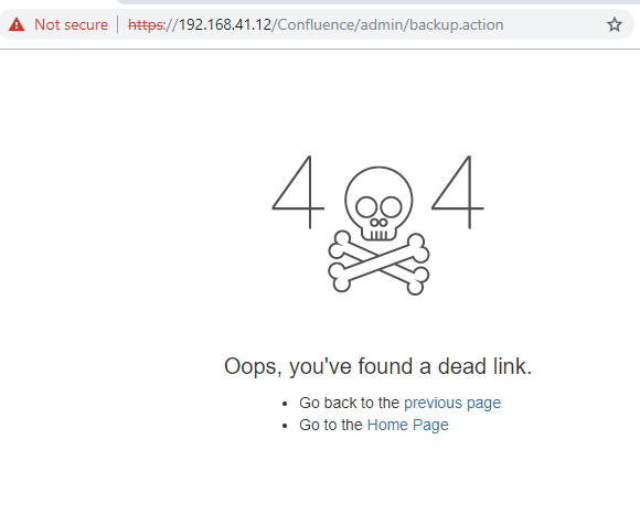

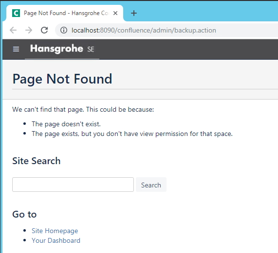

Based on the kb article mentioned above I assume the correct URL to proceed a backup of Confluence through the backend Tomcat should be:
http://localhost:8090/Confluence/admin/backup.action
When I proceed this URL on the server in neither IE or FF, I only get a 404 page not found.
The developer tools of the browser are prompting a 403 authorization required.
Based on this, I tried to create a Token in the same browser session. The login page seems to accept the credentials (both AD and local directory), but the behaviour remains unchanged.
Also when using https and / or different Port (8091) does not make any difference.
Based on this, my question is if the URL I am using above is correct? Am I missing something?

thanks for your fast feedback.
Sorry, did not correctly describe it in my post:
I have ensured that I was accessing the URL from the Confluence server, so localhost was referring to the correct host. In my opinion it also seems that the URL is somehow correct, as the 404 page not found is a site in context of Confluence.
I have also tried to start the backup from remotely (not server itself). But mostly same result.

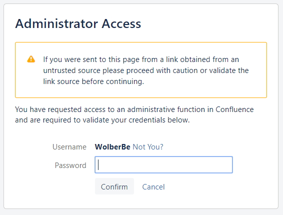

Might it be an issue with authorization? (as the browser developer tools state a 403 authorization required)
When I'm doing backup from the Admin site, logging in to Confluence requires credentials....
....and when accessing the Settings-section, I am prompted for Admin-credentials.
Might it be the case that the authorization fails as a second log in "as Administrator" is required?
I have tried to log in as administrator (above) and then, in the same browser session (to share the token), execute the backup.action URL. But also this results in the page not found exception above.

Do you try to access directly the backup URL ? If yes, you should actually do the entire process using the IP address at the beginning:
I believe this should work, I have tried it myself on a Confluence instance and works fine.
Let me know how it goes,
--Alexis

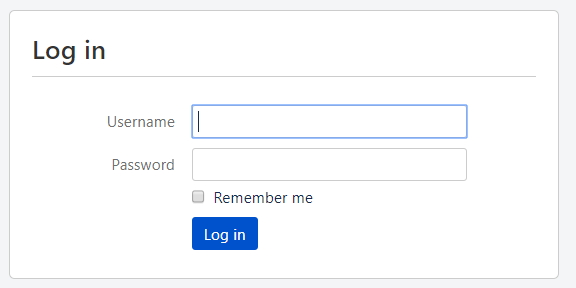

From http://192.168.41.12:8090/ I am prompted for the Confluence login page. When providing valid credentials, there is no redirect to a site within Confluence, just reloading the login-page.
When I enter Confluence via DNS https://confluence.company.com, after logging in I am redirected to https://confluence.company.com/#all-updates. So at this point, I am having a valid token. Now, when manually changing the URL to http://192.168.41.12:8090/#all-updates, it again prompts me for credentials.

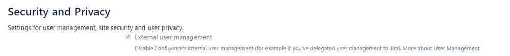

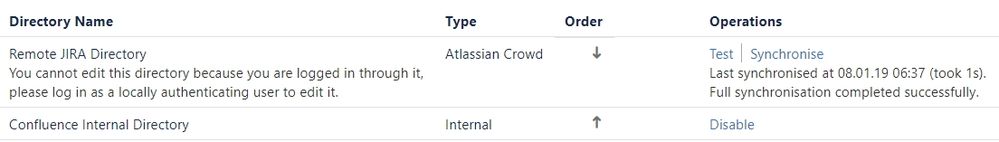

As the login page does not make a redirect after login, my feeling was that this might be related to the underlying user-directory. So I had a check for there.
Currently, our Confluence refers to JIRA, the built in Confluence directory is created, but disabled.
As a test, I have unchecked the "External user management" (in order to get the internal Confluence directory working), changed the order of the two directories (1. Confluence, 2. JIRA), and created a new user within the internal Confluence Directory.
Then, having this user, I tried to proceed the steps mentioned above (log in to http://192.168.41.12:8090 - http://confluence.company.com). But the situation remains the same. After providing credentials, there is no additional action.
