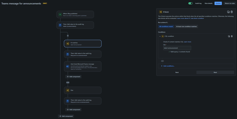

I'm trying to set up an automation rule to send an MS teams message when a blog post with the "announcement" label is published in a specific Confluence space. I have set up the rule to use the "label=announcement" CQL condition, but it is not triggering when it is supposed to.
Here is a screenshot showing how I have the rule set up:
You can see here I added some logging actions to verify that the problem is not with the MS teams message action. Note that I clicked "validate query" on the CQL query condition and it says "Valid query. 2 contents found." Clicking this link shows two existing blog posts that match my intended criteria.

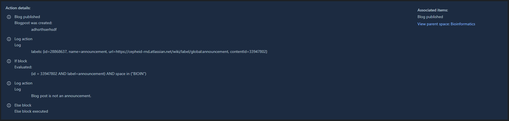

This is an entry in the audit log for a blog post which should have triggered the message but did not:
The log shows the following condition evaluated in the IF block:
(id = 33947802 AND label=announcement) AND space in ("BIOIN")

Looks like you validated the IF is being triggered and the Audit log is being updated.  I would look for some evidence that Confluence tried to send the message to Teams.
I would verify that the Teams connection is configured correctly and test it outside of an automation.  I'd also move the audit log (or add a second one) to after the Teams call.

If you look at the audit log, it displays the message "Blot post is not an announcement" which comes from the log action in the "else" block. Unless I've structured the if/else wrong I think this means I'm not hitting the message action. I have also verified the Teams webhook is working independently.
