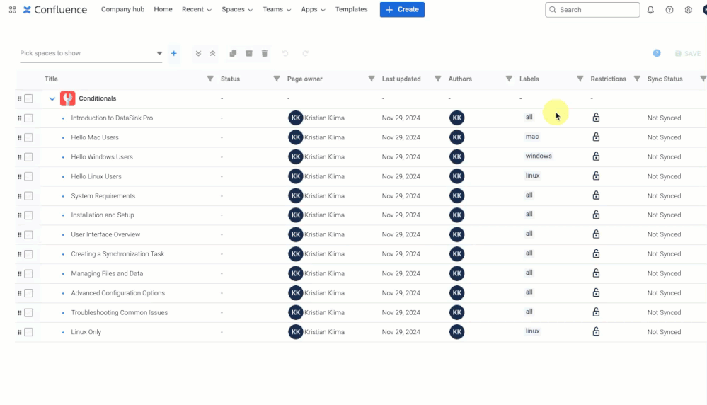

You can use a free app called Pages Manager by Ricksoft.
You can load multiple spaces in there, expand all pages, and apply the label to multiple spaces at once.

Very likely. I checked triggers on pages and it'd be hard to find a common denominator to label all pages based on existing options that would work without additional manual trigger.
I guess it could be done programmatically (I'm not an expert) but somebody took advantage of that already and built a free app that does that.
There's actually another app - Scroll Variants, which is an extension of Scroll Documents - that can label all pages, or a parent + child pages, but it serves a completely different purpose (Conditional content) and labelling is a part of the setup.

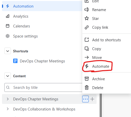

@Jesper Jordan I had this same problem, "Where is the manual trigger button?!"  The documentation always shows it in the top right of any given Confluence page.  Well, I gave up on this for a week or two, and then I found it in the ellipsis menu for any given page.  I have the same use case as you.  I still haven't figured out how to add labels to just a page tree though.  My first attempt added all the label to every page in the entire space.
Kind of annoying there are so many "That's not possible, buy this app" answers here.  It is clearly possible:

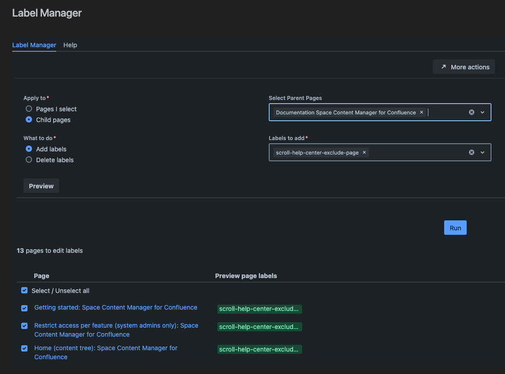

@Aubrey Robertson what use case did you solve using automation?
As for "I still haven't figured out how to add labels to just a page tree though" it is not what you want to hear but likely requires a paid app.
Here is a screenshot from our doc space using Label Manager by Easy Apps (our app). You can choose any parent page and then add a label to it and all the children in one action.
