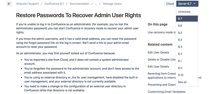

You may recover access to your Confluence instance by using recovery mode if you are using Confluence 6.5.1 or above. Otherwise you will need to directly modify the database. For instructions on logging in with a user from the internal directory, please see: Restore Passwords To Recover Admin User Rights You will need to choose your Confluence version from the pulldown as shown in the screen shot:

After logging in as an admin from the internal directory, please go to the Confluence Admin console and edit the Jira User Directory to reflect the Jira URL change. Please see Jira Settings in Confluence for details on these settings.

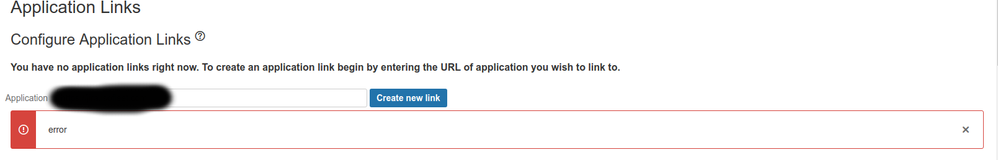

Sorry to write after a long time. I have recovered the admin account on confluence instance, now the problem is that I can't link JIRA and confluence both. If I add application link on jira (for confluence) selecting the option that I have same usernames on both instances but unchecking the option that I am admin on both, it adds the application link on jira and gives me a url to run as admin on confluence, if I do that I got an error. And on the other way round, if I create application link on confluence (for jira) selecting the same options as mentioned above, it simply throws the error (see screenshot) but on refreshing the page, I can see the application link but I think that is of no use.Screenshot from 2018-04-18 14-36-20.png
