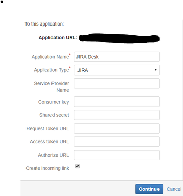

To link application I have logged into confluence outside VM as admin and visited general configuration -> configure application link -> pasted JIRA link in box and clicked create new link I get this box. Do I have to enter consumer key, shared secret etc... ?
Also I have added following lines in server.xml (at the bottom of the file to run this over SSL). But this will not make any difference.
