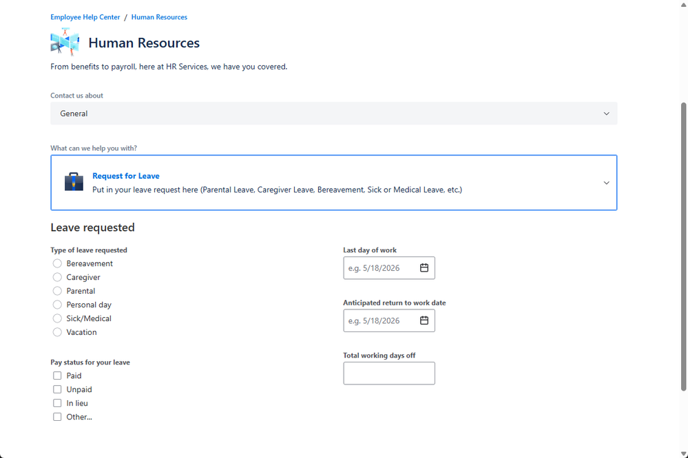

I just checked how Atlassian suggests using a similar approach (for requesting a leave) and here's how request type looks like (this is a demo site from Atlassian):

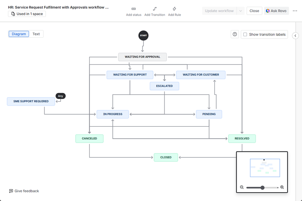

Here's also how their workflow looks like:
You can build it for sure, it's just how you will handle those requests once they are created (as it appears you're struggling with that part).
A couple of suggestions:
  • Use separate queues for Verification and Reschedule cases - make a distinct request type for each
  • To prevent tickets from 'stalling' in a waiting status, you could build automation with scheduled trigger that runs daily, with JQL:
    status = "Waiting for Customer" AND NOT status changed after startOfDay("-5")
    After which a comment is added and potentially the request is closed 👀
  • You can also ensure that you have a rule that transitions the ticket back to "Waiting for Support" as soon as a customer adds a comment or document.
  • Another automation you could build is an SLA-related one (e.g., "Time to respond") that starts when entering a waiting status. Use the SLA threshold breached trigger to automatically nudge the customer or alert the agent.
It really depends on how you'd like your process to look like, but it's all doable.
