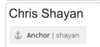

This is how I declared the anchor:

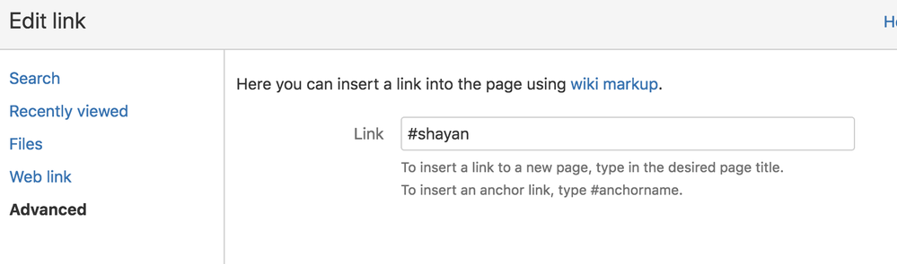

and this is how I created the link:

Are you using Sections?
The steps taken on my test:
- Put the page on Edit mode.
- Select some text (on my case, 'anchor test') > click on Insert link icon > Advanced > add the info: Link: #anchortest, Link text: below.
- Add some text to the page below the link.
- Add the Anchor macro by typing {anchor}.
- Inside the 'edit macro', add the Anchor Name: anchortest > Save.
- Publish the page.
- Open the page on the Confluence Cloud app.
 Afterwards I tested using separated sections for the link/anchor, and it still works.
