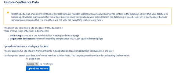

For you to be able to restore spaces in Confluence 6.12.2, the instance from where the spaces are coming from needs to be at least at Version 5.3.x. With this information, we now know that you can import spaces from your Old Confluence at 5.10.x or 6.0.7 version:
However, if you do need to have the older instance upgraded, we may need to better understand what happens after upgrading to 6.1.0. As a note, when you reach Confluence 5.10.x, you could make the upgrade straight into 6.6.9 (our previous enterprise release) or even into 6.13.0 (our current latest). There is not strict need to make the upgrade gradually.
