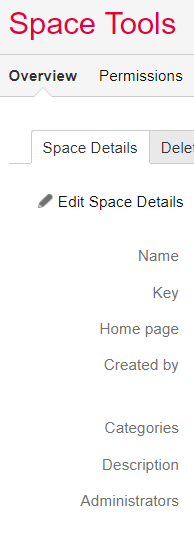

Stefan Mueller
January 7, 2019
to have custom fields here
Davin Studer
January 7, 2019
Would something like Space Fields for Confluence meet what you are trying to accomplish?
