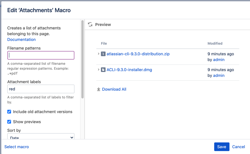

You can filter the page attachments using the attachment macro:
If you have any file pattern you can use extensions like .*pdf or so on.

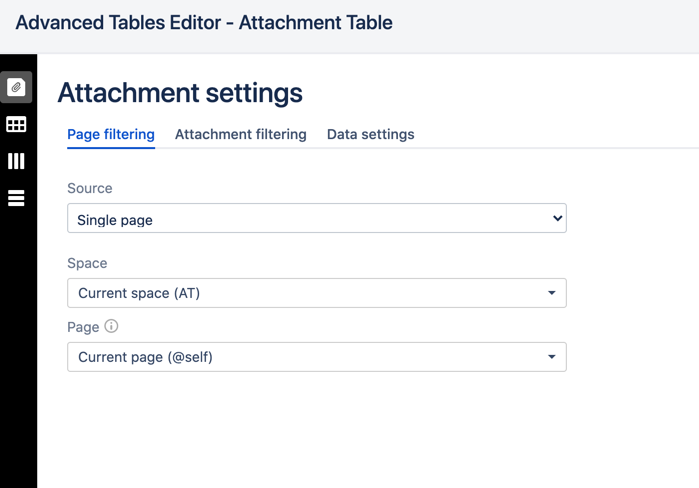

Or else you can use Bobswift's Advanced Tables app - Attachment macro as well, to filter out using labels:

I have tested these macros and from what I've seen these are pre-filtering the attachments, rather than allowing the user to actively search based on labels and then filter the documents out.

Yes, you can achieve this using Bobswift's Run Self-Service Reports for Confluence app along with Advanced Tables for Confluence app.

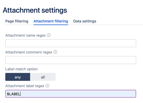

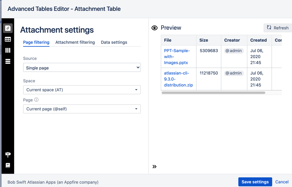

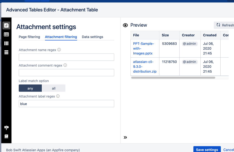

  • Insert the Bobswift's Attachment macro in the confluence and set page filtering as per your requirement.
    And in the Attachmnet filtering section for Attachment label regex add $LABEL

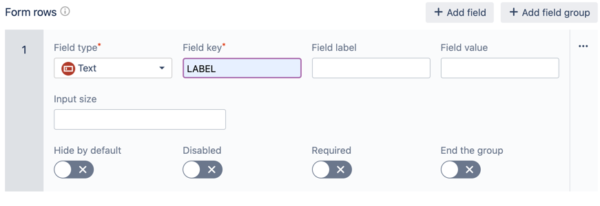

  • Insert a RUN WITH A USER FORM AND PARAMETERS macro which comes from Run Self-Service Reports for Confluence app. And edit the macro and add field though the option available.
    Delete the field Group which is not useful for you in this case. And in the Field Type add Text and for Field Key add LABEL:

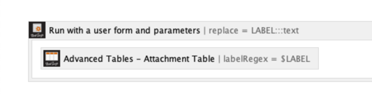

  • Now insert the attachment macro inside the RUN macro:

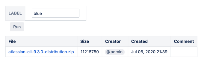

  • Now once you publish the page, you can see the option to insert the label name and once you click run, it will list out the attachments with specified labels:
