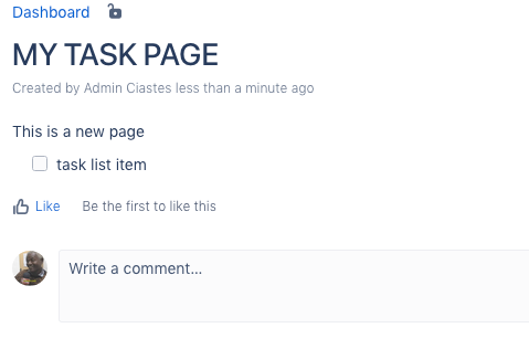

This is the resulting page after sending this curl to my local Confluence instance:
You need to run this curl command from a terminal, either Linux or macOS. This also works with Windows but you will need to install some software before being able to.
