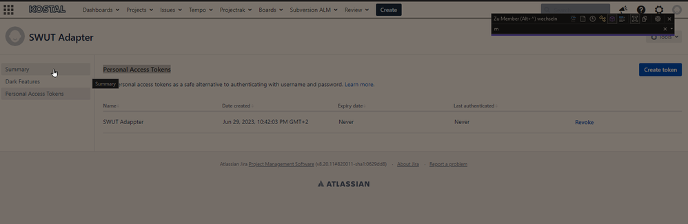

I have the same problem! And I absolutely did not understand your answer @marc -Collabello--Phase Locked- . Please explain yourself. I have created an atlassian account and I am able to create an "API Token" but how should this help me get into our company's own Jira Server???
There is as far as I know no connection between atlassian domain and our implementation of our company's own JIRA server. So  how can I connect with the "Personal Access Token" via rest api. I found an example for c#:

But I am getting an "unauthorized" result from my post request! Please help!
My starting page is like this:
Or is there any supported official library for C#? It should provide a method for token access. I don't need basic auth nor oauth...

Hi @Peter Wein ,
It seems you are using Jira server software.  The answer I provided is for Confuence cloud.
That means my answer dos not work for Jira server!  But the answer works for Confluence cloud.
