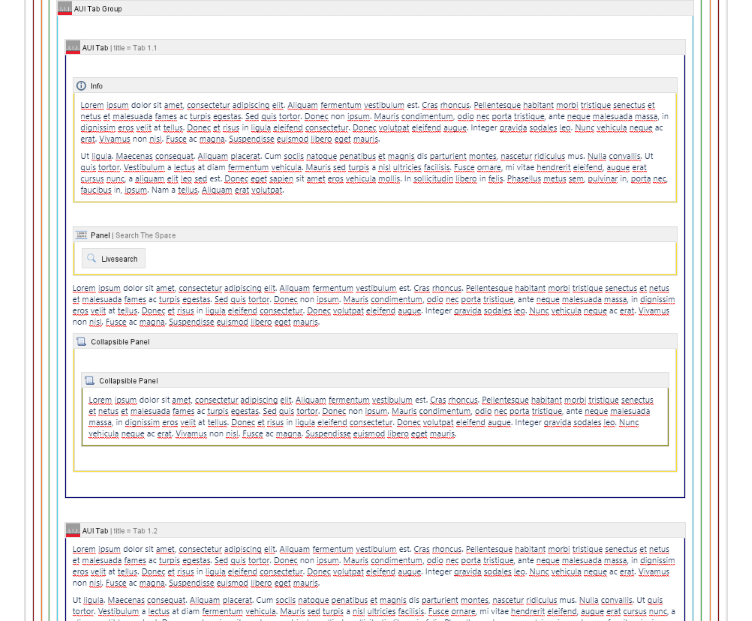

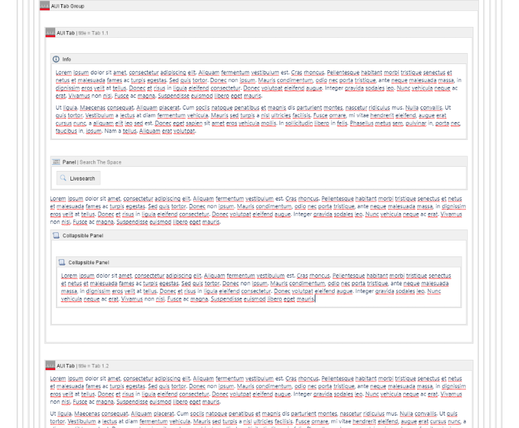

That is the inspiration for this browser bookmarklet. Simply drag the below bookmarklet link to your browser’s bookmarks bar. When you are in edit mode you can click the bookmarklet to change the borders of your macros from this …
greymacros.pngto this …
rainbowmacros.pngEach macro now has a distinctive color making it easy to see which border goes with which macro. Problem solved! Unfortunately, I could not change the color of the macro header. It’s actually a dynamically generated image that is LONG with the grey color hard-coded into it. Also, I tried hard to make sure that each color is distinct from the colors next to it so that it is easy to see which is which. I even thought about color-deficient people with the color choices … as I myself am red/green color-deficient.
