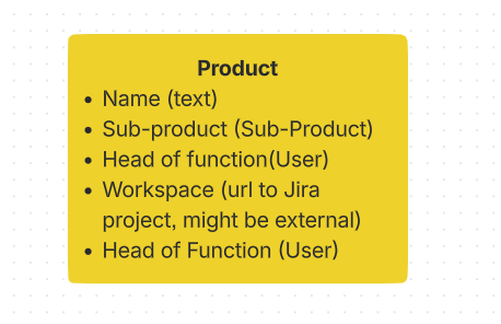

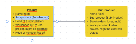

  •  Object types are boxes. I like to use "Rectangles" colored in yellow. Write the name of the Object Type in bold and list the attributes as a bullet list. Notice how I write the attribute type by the name. As a general recommendation, let the first attribute be the object type label. Also, if you reference another object, use the object type name as the attribute type.
  • Whenever your objects are related, create arrows between them: The rule goes as follows: The object that contains the related object has an arrow outgoing towards the referenced object.relation between products.png

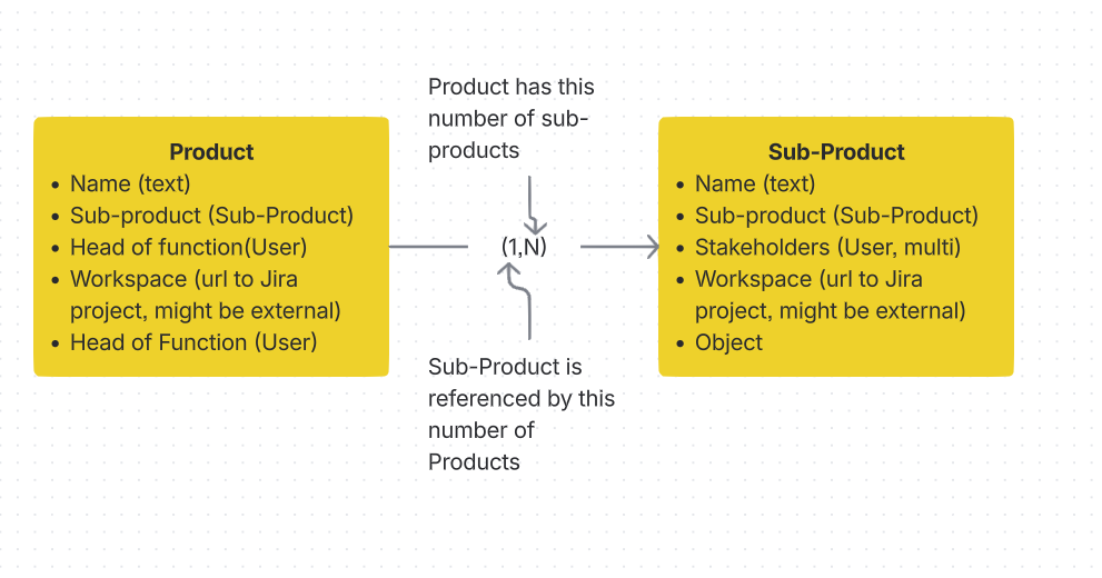

  • Use the relation to specify the cardinality. For example, my Main Product can have any number  (N) of sub-products, yet the Sub-Product may only be referenced by one Product at a time (1)cardinality.png

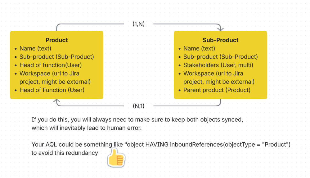

  • Avoid crossed relations. You might be tempted to keep in a subordinate entity the exact objects it is subordinate to. This is not necessary, as you can use the relationships between objects both inwards and outwards. bad practice.png

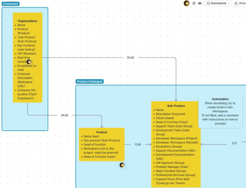

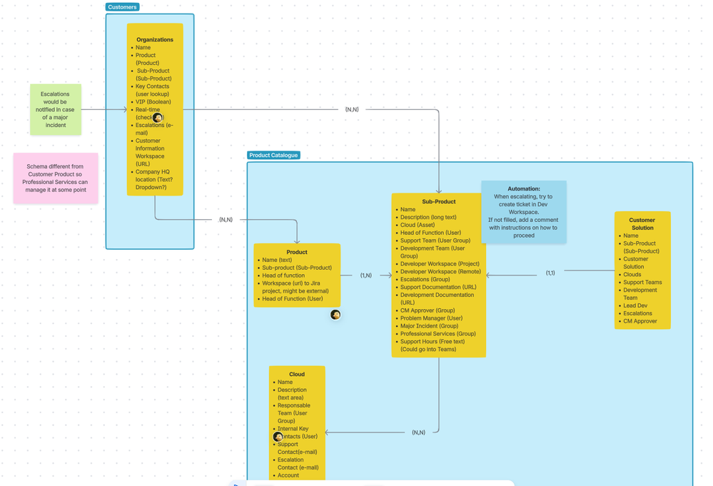

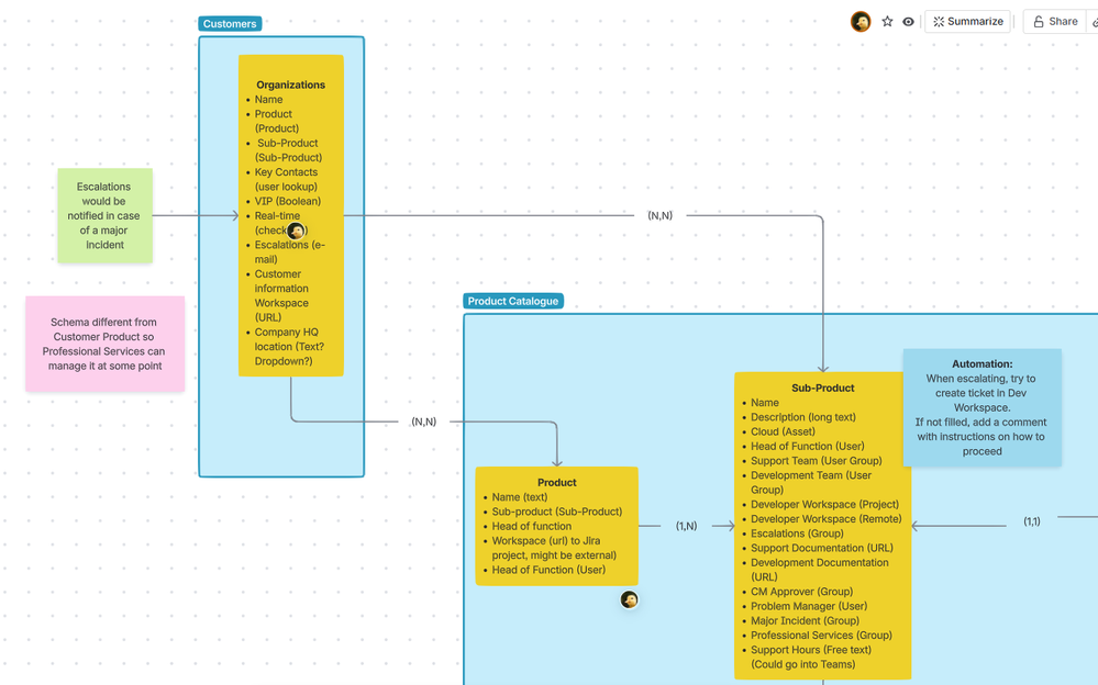

Recently I designed toguether with a colleague and a client a small database whose aim was:
  1. Keeping track of how many clients the company had
  2. Keeping track of the Products this customers had purchased
  3. Keeping a catalogue of Products and their modules.
  4. Cataloguing all their hosting, key stakeholders, support groups, etc for an ITSM service
  5. Automating assignments according to which customer opened tickets in JSM, as the routing could depend on which products they had purchased.
I might write another article outlining my best practices on designing Assets databases. This time around, let's just see the final diagram without zooming in. (Don't worry, I made sure to ask for permission before reposting this)

This is a nice example of how the forced simplicity of Whiteboards removes much of the "techno babble" from diagrams making them easier for staff who are not classically trained on UML to come to grips with the concepts without being overwhelmed by needing to know the minute details about each style of crows-foot arrow.  At the end of the day these tools are to help people work out what to do, and how to do it.

Great suggestion! I like the idea of using the text of a relation as a cardinality. I think cardinality is very important for class diagrams.

One improvement that I've been thinking about is including what type of relationship the objects will have between them, as naming relationships is real usefull when configuring Assets custom fields in Jira.
Maybe the community can offer some ideas on how to do this elegantly.
