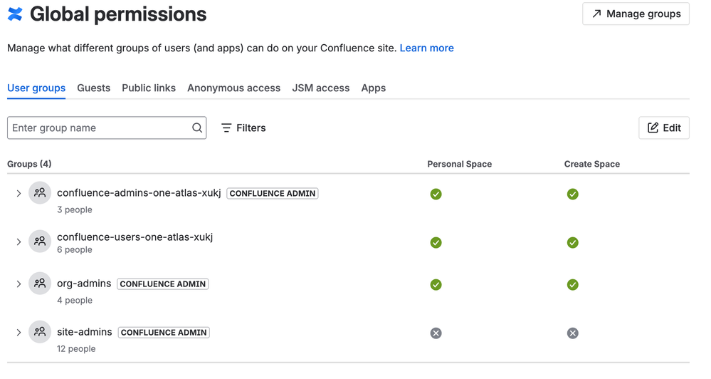

Global permissions define what individuals can do across the entire Confluence instance. These are managed by the Confluence Admin and are typically things that are set up when Confluence is installed and then left alone. I loosely group them into two groups - individual permissions and access permissions.
Individual Permissions
This group provides specific permissions to individuals who have a Confluence license. First there is “Create Space”, which allows someone to create new Spaces in Confluence. Typically I see this only provided to a limited number of folks. This helps ensure that spaces are created appropriately (e.g. you don’t end up with three versions of “Support Team”). Most places I work with reserve this permission to either admins or a (very) small set of individuals. It’s also worthwhile to put a process in place for requesting a new space from these folks (e.g. through Jira Service management) to help manage everything.
Next up is “Personal Space” which provides a space to each licensed individual named after them. This is one of my favorite parts of Confluence as it gives users a place they can go to make their own content, experiment with things and basically do whatever they want. It’s an important safety valve (since it lets them make anything) and a useful tool to let folks use Confluence.

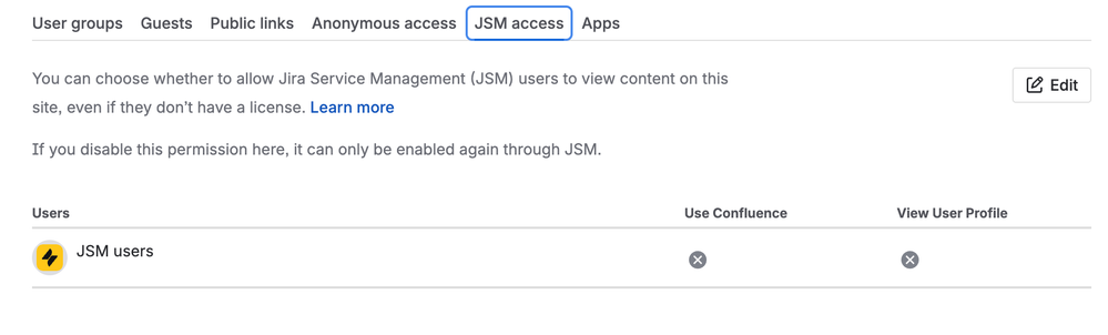

JSM access lets you give access to Confluence to agents, even if they don’t have a Confluence license. This helps ensure your agents can get access to articles to resolve tickets without needing to get them a license. There’s two options here, Use Confluence and View User Profiles.
