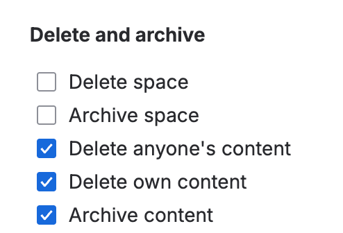

Permissions
Both of these features are controlled by space-level permissions. This means your ability to do either can vary from space to space (which can be confusing and frustrating! When in doubt, chase down a space admin and ask for help). Typically groups will restrict the ability to delete things, since at best this requires an admin to intervene and pull it out of the trash, but at worst can result in content being permanently removed from the system.
In the new RBAC permissions set there are three permissions that relate to archiving and deleting content:
  1. Archive Content - allows someone to archive any content they can view.
  2. Delete own content - allows someone the ability to delete only content they created.
  3. Delete any content - allows someone the ability to delete any content they can view
Typically groups will allow “Archive Content” for a wide range of folks, with “Delete own” a bit more narrow, and “Delete any” very tightly controlled. There are also some interesting combinations where your Space admins (the people who can purge the trash) don’t get “Delete any” access - this helps segregate duties and prevent potential abuse.
