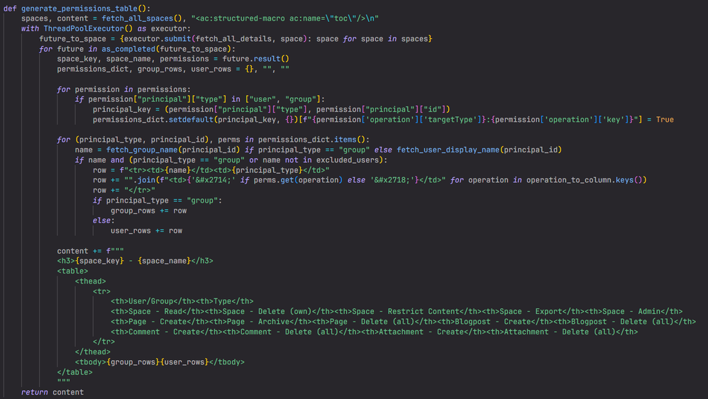

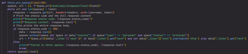

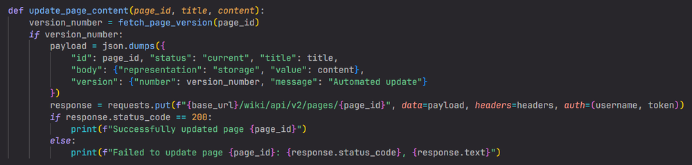

Please find the relevant functions as follows (I don't find any way to post the code here in a proper way, so I just made screenshots of it):

There is some ... interesting Python syntax going on here that I don't quite understand:
row += ""-join(f"<td>{'&#x2714;' if perms.get(operation) else '&#x2718;'}</td>" for operation in operation_to_column.keys())
(Also, it would probably be easier for people to debug and test this if you posted the actual code. Like maybe as a Snippet?)
So... what I would do is modify the script to echo the final content variable to a file.
Then install Storage Format Editor for Confluence FREE and try copy/pasting the content your script generates into a blank test page on your site.
Hopefully that will reveal where ChatGPT (oy) went wrong.

thanks for your feedback and raising this idea, I put the whole script into a snippet in our companys Bitbucket instance for better debugging: https://bitbucket.org/hermesgermany/workspace/snippets/5qgK4A/space-permissions.

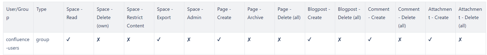

Concerning the line you mentioned: this one puts a check mark when a user has a certain permission or a cross mark when he has not. The syntax should be okay, as it works fine when the script is limited to 20 spaces. In the end it looks as follows:
