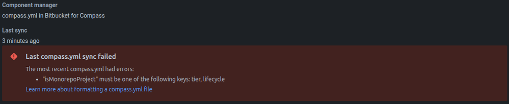

John Homenuke
September 23, 2025
I tried nesting `isMonorepoProject` under `fields` and I got this error response:
