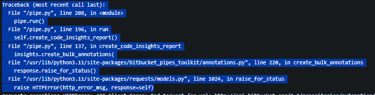

Sathish Kumar Reddy
October 11, 2024
Hi Igor,
im using this owasp dependency check pipe
- pipe: atlassian/bitbucket-dependency-scanner:0.1.2
this is custom run step
dependency-check:
- step:
services:
- docker
script:
- mkdir -p $BITBUCKET_CLONE_DIR/dependency-check-report
- npm install
# Get the first 8 characters of the Bitbucket commit hash
variables:
NVD_API_KEY: "api key"
EXTRA_ARGS:
- "--format=HTML"
- "--project=backend-report"
REPORT_DIR_PATH: "./dependency-check-report"
DEBUG: "true"
# CREATE_REPORT: "true"
artifacts:
- dependency-check-report/**
and this is error
after the pipeline failed im getting the report in artifacts but not sure why its getting failed.
and thank u for responding..
Regards
Sathish
