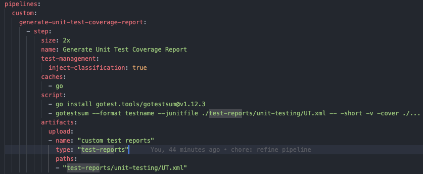

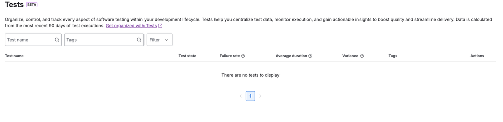

- I wrote a simple custom pipeline to generate unit test output
- I add a dummy test to make the pipeline failed since the topic said only failed test would shown on test tab but the tab still empty
- no self-hosted pipeline were set in the configuration
- my workspace is on standard plan
- i read most topic about this new feature but didn't help
Big thanks for any support !

Thanks for your help. Based on my current understanding, I believe I have already covered the points you mentioned.
I already converted the Go test output into a supported JUnit XML format using gotestsum.
I also intentionally added a failing test, since I understand that only failed tests are shown in the Tests tab.
However, the Tests tab is still empty, which is why I’m confused.
From the screenshots I shared, it seems that I already tried both generating JUnit XML output and making the pipeline fail on purpose, but I still could not get the expected result.
So I’d like to ask whether there might be any other requirement, limitation, or configuration that I may have missed.
Thanks again for your support.
