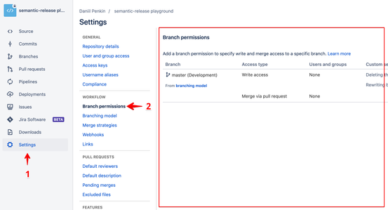

What do you see on the right side of the screen? Is there a table with some rules, like one in the red rectangle on my screenshot?

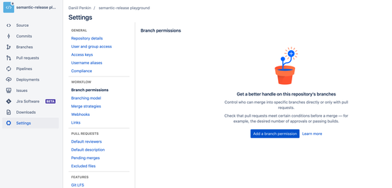

Or is there an empty state screen, like this one?
If you have some branch permissions (like on the first screenshot) please double check their configuration or post a screenshot here – I believe you have a rule preventing pushes to your master branch.

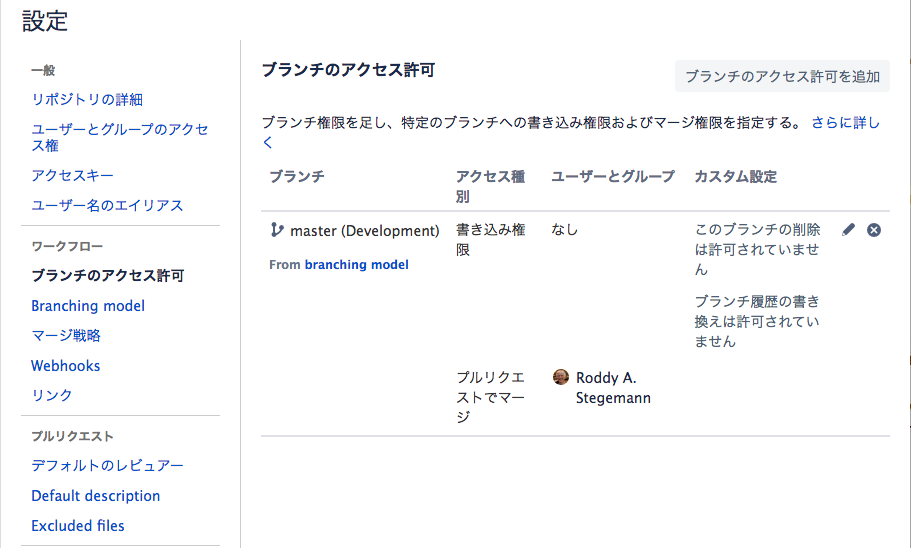

kiusau
December 15, 2019
My menu is not blank, as you suggest, but I see nothing that would deny my ability to PUSH unless, of course, there is something about a PUSH command that I do not understand.  This latter is, of course, very likely, as I am still very new to Bitbucket and the use of GIT.
Now, it does add special restrictions, but these restrictions, if am reading them correctly restrict only two things:  one, the ability to destroy the branch, and two, the ability to change the history. But neither, of these two restrictions refers to a specific group or user.
Finally, the owner (me) is listed, but in this context only mention of my recent PULL and MERGE requests is made.

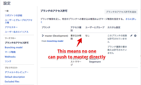

So from your initial post, you're trying to push some commits to master but get this error back:
00:19:32.131730 pkt-line.c:46 packet: push< \2Permission denied to update branch master.
remote: Permission denied to update branch master.
This is because you have a restriction to not allow anyone push to master:
The only way to apply changes to master with your current setup is to open a pull request against it, which then can only be merged by you (this is the second setting in that permission – where your username is shown).
If you want to be able to push to master directly, you need to update this branch permission or remove it (depending on what is the desired workflow you'd like to enforce).
Hope this helps. Let me know if you have any questions.

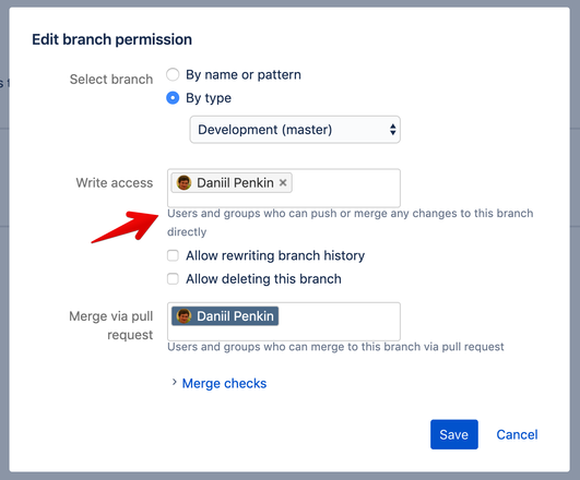

There's no way to blacklist users, only whitelist. That is, you can allow only some specific users to push directly – if you add only yourself, no one except you will be able to push to a branch directly.
Or, is that even necessary so long as I check to see what he has done before pulling his changes to my own local repository.
This depends on the repository permissions settings. If you allow write access, they can write to any branch unless there're branch permissions in place. If you use fork-pull request strategy, you can keep just read access for them, and hence such branch permission isn't necessary.
