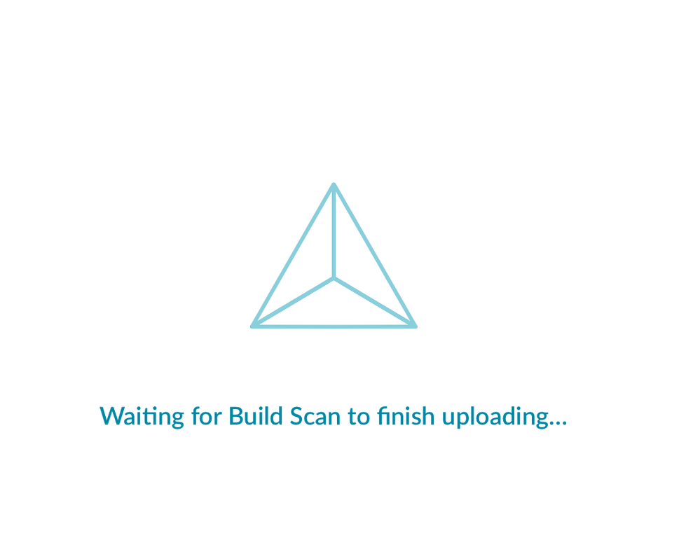

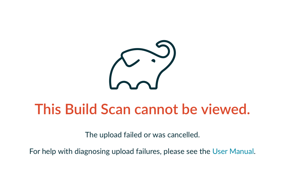

we are running gradle tasks with the --scan parameter in our pipelines but most of the time they cannot be views afterwardsScreenshot 2023-04-14 at 16.25.18.pngScreenshot 2023-04-15 at 22.46.19.png
what could be the reason?

Hi Thomas,
I do not recognize these screenshots, are these from a third-party application? If so, are you uploading in this application scan results while a Pipelines build is running?
If this is the case, I would suggest adding a flag for verbose output (if available) to the command(s) in your bitbucket-pipelines.yml file that upload these scans. Then, the output of the command(s) may give you an indication of what is going wrong with the upload.
The second screenshot you attached seems to have a link to a 'User Manual', this may have additional info on how to troubleshoot the issue.

Thomas Einwaller
April 19, 2023
the images are from the gradle server where I want to view the results of the build scan

but when I click I get the errors shown above
The manual behind the links says that I could get more information by looking into
~/.gradle/build-scan-data/upload-failure.log
is there a way to get that file from my pipeline?

ok, tried those and found that there is no
created - which means that the gradle task did not encounter a problem while uploading

Thomas Einwaller
May 4, 2023
what resolved my problem was to disable background uploading as explained here https://docs.gradle.com/enterprise/gradle-plugin/#configuring_background_uploading
