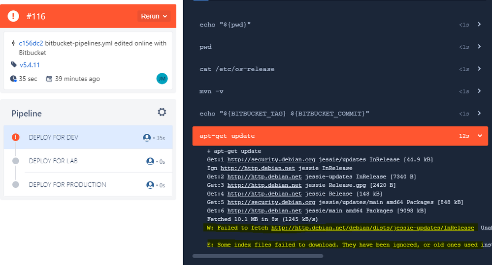

Hello community,
How can I solve this problem. I have read forums and I have not found the solution.
first attempt:
i put line [ - sed -i '/jessie-updates/d' /etc/apt/sources.list ] and then failed mvn clean
im using image: maven:3.2.5-jdk-7

Hi @JMONTOYAAIT
You probably know that this issue is not caused by Pipelines itself, but for an archived reference from this old Debian image.
I was able to test this image with docker in my local machine and saw the same error you had. Tried to find the solution for it and found one in this thread:
To solve the issue you need to add the following line before your apt-get command:
printf "deb http://archive.debian.org/debian/ jessie main\ndeb-src http://archive.debian.org/debian/ jessie main\ndeb http://security.debian.org jessie/updates main\ndeb-src http://security.debian.org jessie/updates main" > /etc/apt/sources.list
I hope it helps.
