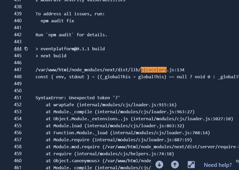

Hello,
My pipeline return error on ssh-run step:
YML file:
image: node:latest
definitions:
  steps:
    - step: &build-test
        name: Build and test
        caches:
          - node
        script:
          - npm install
          - npm run build
        artifacts:
          - .next/**
    - step: &deploy
        name: Deploy artifacts using SCP to PROD
        script:
          - &deploy-script
            pipe: atlassian/scp-deploy:0.3.3
            variables: &deploy-variables
              USER: $USER
              SERVER: $SERVER
              REMOTE_PATH: '/var/www/html/'
              LOCAL_PATH: '${BITBUCKET_CLONE_DIR}/*'
          - &ssh-script
            pipe: atlassian/ssh-run:0.4.3
            variables: &ssh-variables
              SSH_USER: $USER
              SERVER: $SERVER
              COMMAND: 'cd /var/www/html && npm install && npm run build && npm run start'
pipelines:
  branches:
    develop:
      - step:
          <<: *build-test
          name: Build and test on develop
      - step:
          <<: *deploy
    production:
      - step:
          <<: *build-test
          name: Build and test on production
      - step:
          <<: *deploy
          deployment: production
          script:
              - <<: *deploy-script
                variables:
                    <<: *deploy-variables
                    SERVER: $SERVER_PRODUCTION
              - <<: *ssh-script
                variables:
                    <<: *ssh-variables
Thank you in advance for any assistance!

Hi @anhtruc92cr
The error does not appear to relate to Pipelines, that error is NPM specific and mentions the picocolors dependency, essentially the error means that the parser cannot interpret the code as there is an issue with the command syntax.
As you are using the latest node image, I'd suggest downgrading to a previous node version (if these commands were working in the past), or updating your version of the picocolors dependency.
Cheers!
- Ben (Bitbucket Cloud Support)
