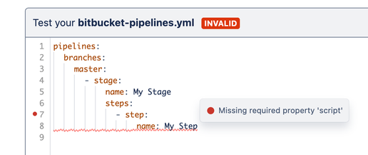

The online validator is unfortunately indeed quite limited. For example, it doesn't handle a file with anchors and aliases at all. We are aware of this, and we will eventually improve it. The online validator also doesn't use the JSON schema, which has been introduced relatively recently.
However, the block you mentioned is actually highlighted as invalid by validator, and it shows the reason: script is missing in the step.

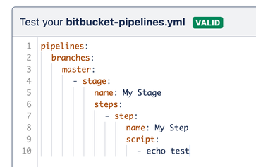

Once I add a script with a command, it becomes a valid configuration:image.png

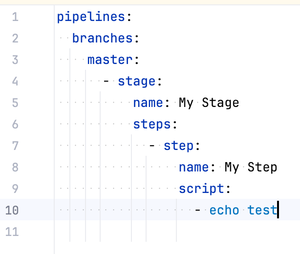

But this configuration looks valid in IntelliJ equipped with the JSON schema:

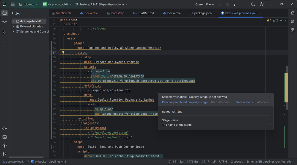

See a screenshot of the issue below. The "BB pipelines configuration" schema is me telling WebStorm to validate against the remote URL for the JSON schema just to be sure it's not using a bundled version or some other source.

Thanks for the screenshot, now it's clear what is wrong.
The problem is with the indentation of one of the step properties: lines 39-45 should be indented further to appear under their parent step (check out lines 47-50, for example – they are indented correctly).
Unfortunately, errors produced by JSON schema validation engine in IntelliJ sometimes don't point at the problem exactly, nor do they provide a detailed description of what was expected vs what was found.
I hope that one day we will come up with a better validation tool, but for now this is what we've got.
Let me know if this helped.
