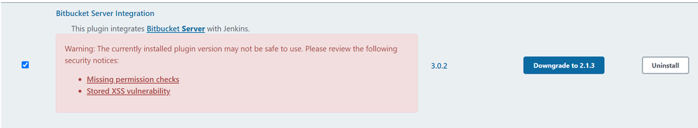

We suspect bitbucket server integration plugin behavior can be related (since builds mentioned in the log are the only builds that use bitbucket server connection to repository).
jenkins: v2.263.1, bitbucket server integration: v2.1.3, bitbucket server: v7.6.16
The impression is that any job connected to specific bitbucket repository with "Bitbucket Server" updates last commit (of mentioned repository) build status.
Can someone confirm this is an expected behavior?
white fluffy
September 6, 2022
Can someone confirm bitbucket server integration plugin logs the following posting messages? 20220906_jenkins_bitbucket_server_notifications.png20220906_jenkins_bitbucket_server_notifications_02.png
