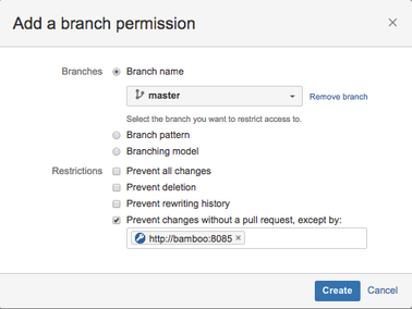

In Bitbucket Server, it is possible to configure Bamboo as an exception to the branch permission rules.
This can be done using the Access Key that Bamboo adds to Bitbucket Server when a repository or a branch is added to a plan.
For example, if you want want Bamboo to be able to write to the master branch directly while all other users can only do that via a pull request, you can define the Branch Permissions in this way in Bitbucket Server:

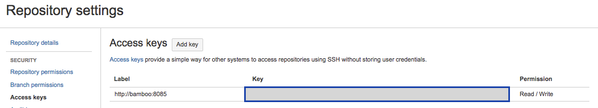

The value in the "except by" field corresponds to the Access Key that you can find in the repository settings in Bitbucket Server:
This feature is available since Bitbucket Server 4.14.0 as announced in the Add access keys to branch permissions blog post.
