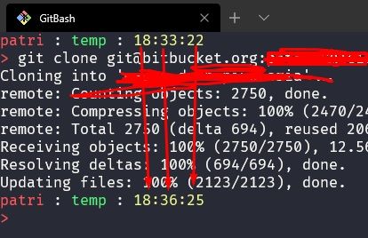

After lunch I try to push, and the git push stuck, no message, just do not work. Then I try clone... I wait... wait... and after 10min, I receive 1 error mesage... after 2 minutes, another error message, then... the clone start, incredible slow.
I dont know how to solve that.
git clone git@bitbucket.org........git
Cloning into 'XPTO.......

remote: Counting objects: 2750, done.
remote: Compressing objects: 100% (2470/2470), done.
remote: Total 2750 (delta 694), reused 2069 (delta 230)R
Receiving objects: 100% (2750/2750), 12.56 MiB | 1.37 MiB/s, done.
Resolving deltas: 100% (694/694), done.
Updating files: 100% (2123/2123), done
I try do clone after post this... and now works BUT with a 3 minutes delay. A repository incredible small and using a 50mb ISP.
